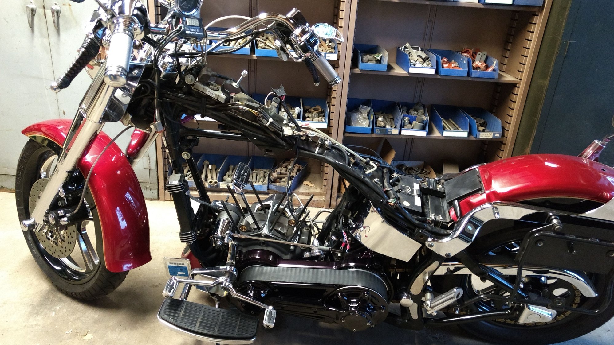

Over the last week or so I've been able to replace the starter and completely assemble the oil lines and the primary drive... I should have the pistons and cam back next onday or Tuesday.
I have a Baker SBD belt drive for the primary and since I've installed it I've been having problems with the Starter Jack shaft lining up with the ring gear..... Mark at baker has been very supportive of my problem but I was never able to remedy it, till this past week (I think, Ill know more when it's all done....). With the starter bolted up to the trans and the primary bolted up as well I was having a very difficult time getting the jack shaft onto the starter.
With the oil tank out of the way I could see clearly that the alignment of the three components (trans , starter, Primary drive) was not spot on. I thought it was because of the starter and purchased a new starter but with no avail.... If I loosely fit the starter and jack shaft if will go together but when I tighten it down the jack shaft binds in the bushing and will not engage the ring gear.
So what I did was actually shim the starter (like we used to back in the day on our chevy's) and now the jack shaft will slide out and back in without binding and hitting the side of the ring gear. I think the actual problem is with the trans and how the starter mount was machined....
Any one ever run into this with aftermarket Parts?
So here's a couple more pics....

Well It's done... 190 ccp, woods W9B, Hillside stage III heads, Axtell 30* angle tops 3.645", S&S 4.625" crank. Was supposed to be set up for 11:1 but because of me is not.... Explanation to follow.....
Everything bolted up real nice and no leaks. Started on three cranks and did 3 heat cycles (150*, 200*and 250).
Have yet to get it out but will this weekend to see if I need any fine tuning.... The thunder jet works real well and the throttle response is awesome... A road test and Dyno will tell me more though... Plugs looked good maybe a tad rich but for some reason the float level was too high so in the beginning it was I little tough to adjust AFR. Pulled the float bowl this morning and readjusted the float level. AFR is now a steady 13.6-14.0 at idle, I'm very happy though.....
The ccp was supposed to be higher but when I initially mocked up the motor the intake lifter was collapsed and it increased my ccp and based on the numbers (that were wrong) Scott milled the piston to correct it. Well once the lifter pumped up, it changed the ivc timing which inturn lowered the ccp. So instead of 210 I'm at 190. Which is actually better for the street. I just hope I don't lose to much performance with the w9b ivc @ 50*. My bad... Still should be a runner though... We'll see....
Just like to thank you Scott... It sounds real good... See you at the Dyno....
