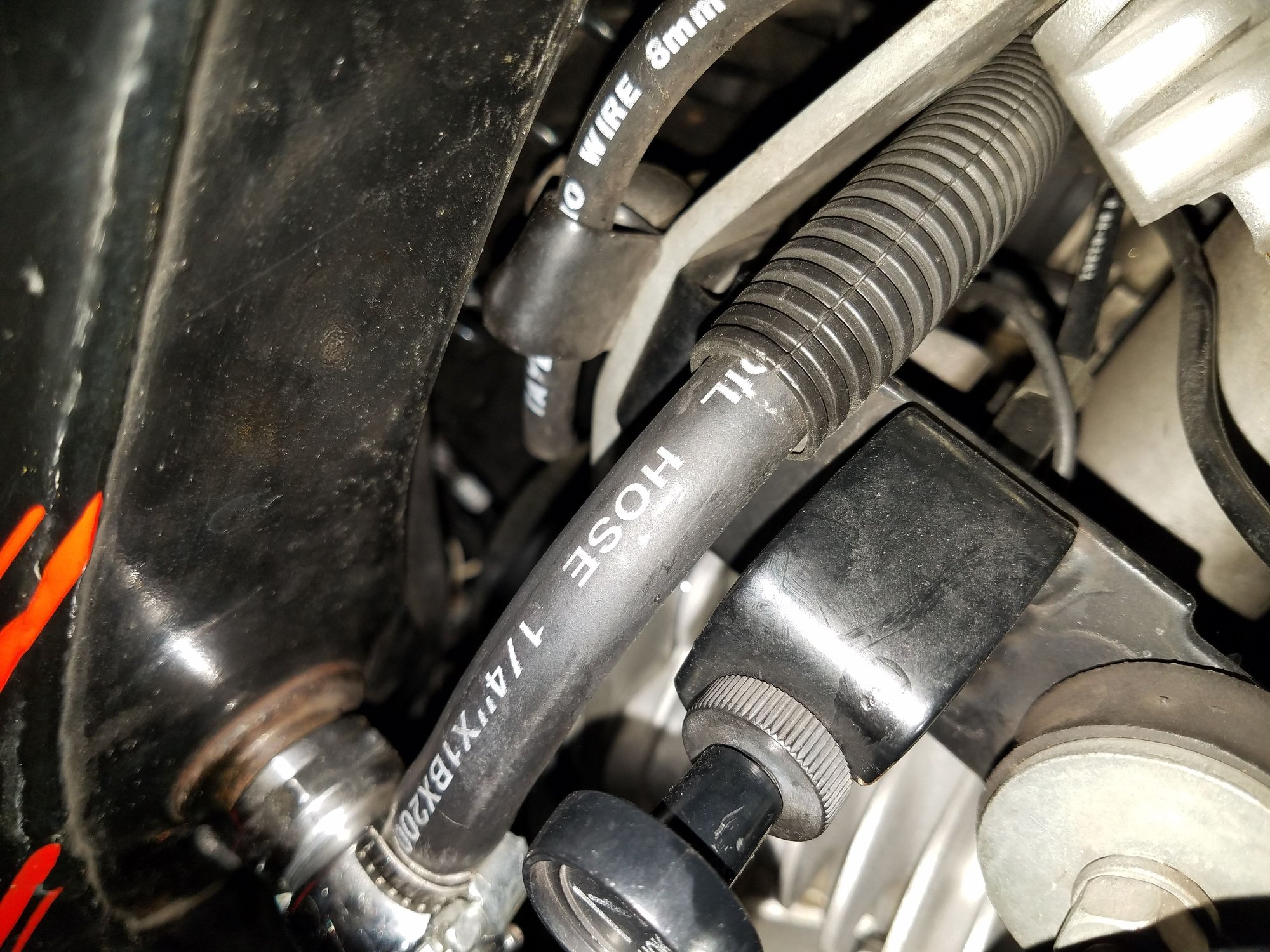

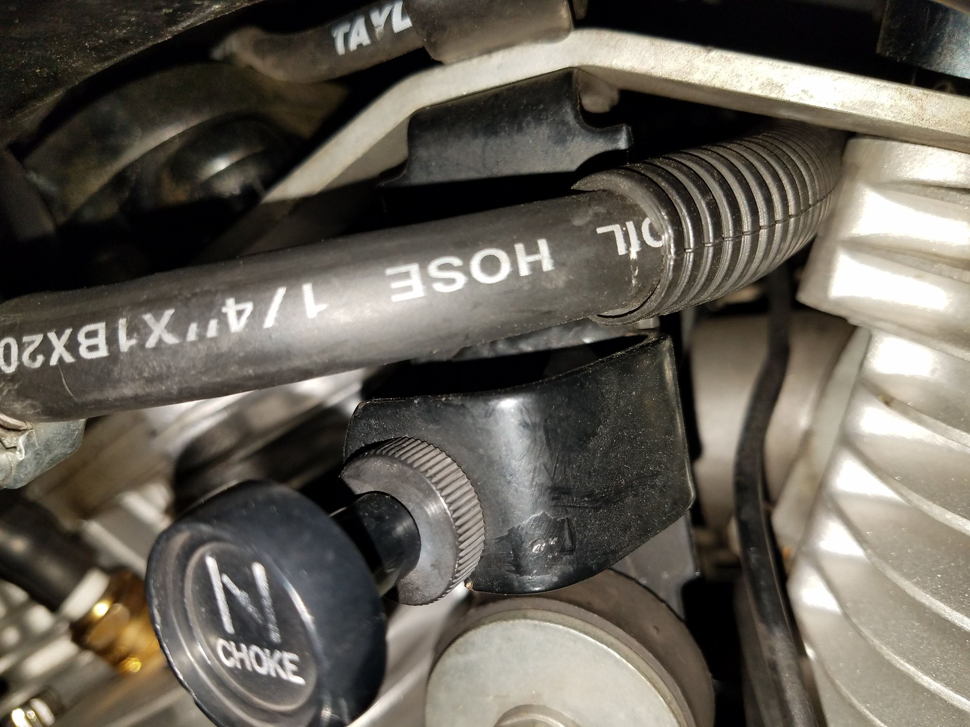

Not sure if this is stock or not, but here's what mine looks like.

Thanks Rivercityslim for the pics. That's the correct stock bracket for the '89 and that's probably what I'll go with seeing as I have an '89 also. I was trying to see how a later model touring choke cable was set up with the afore mentioned #34 bracket.

Mine was long ago modified for a CV, so I can verify that this setup works just fine.
