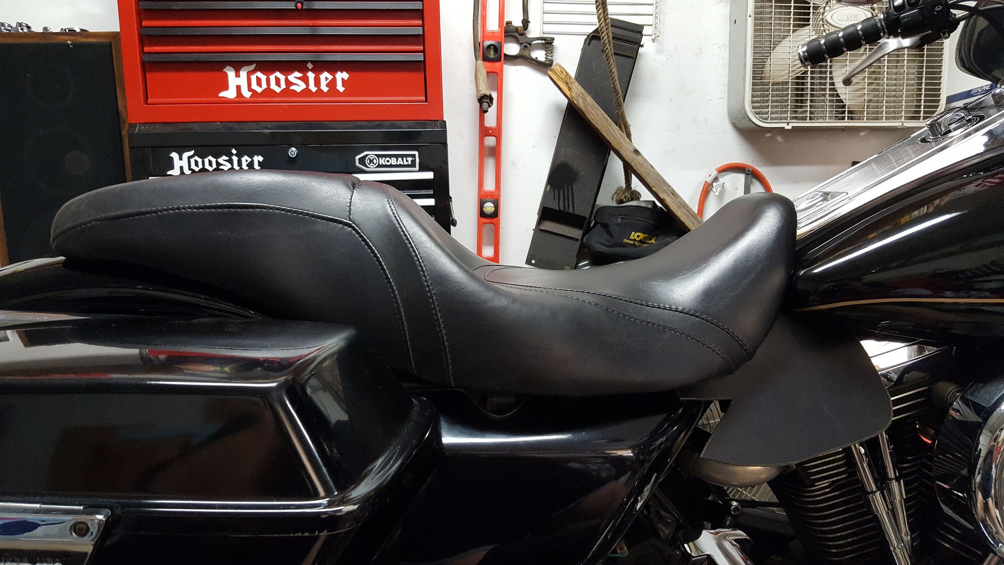

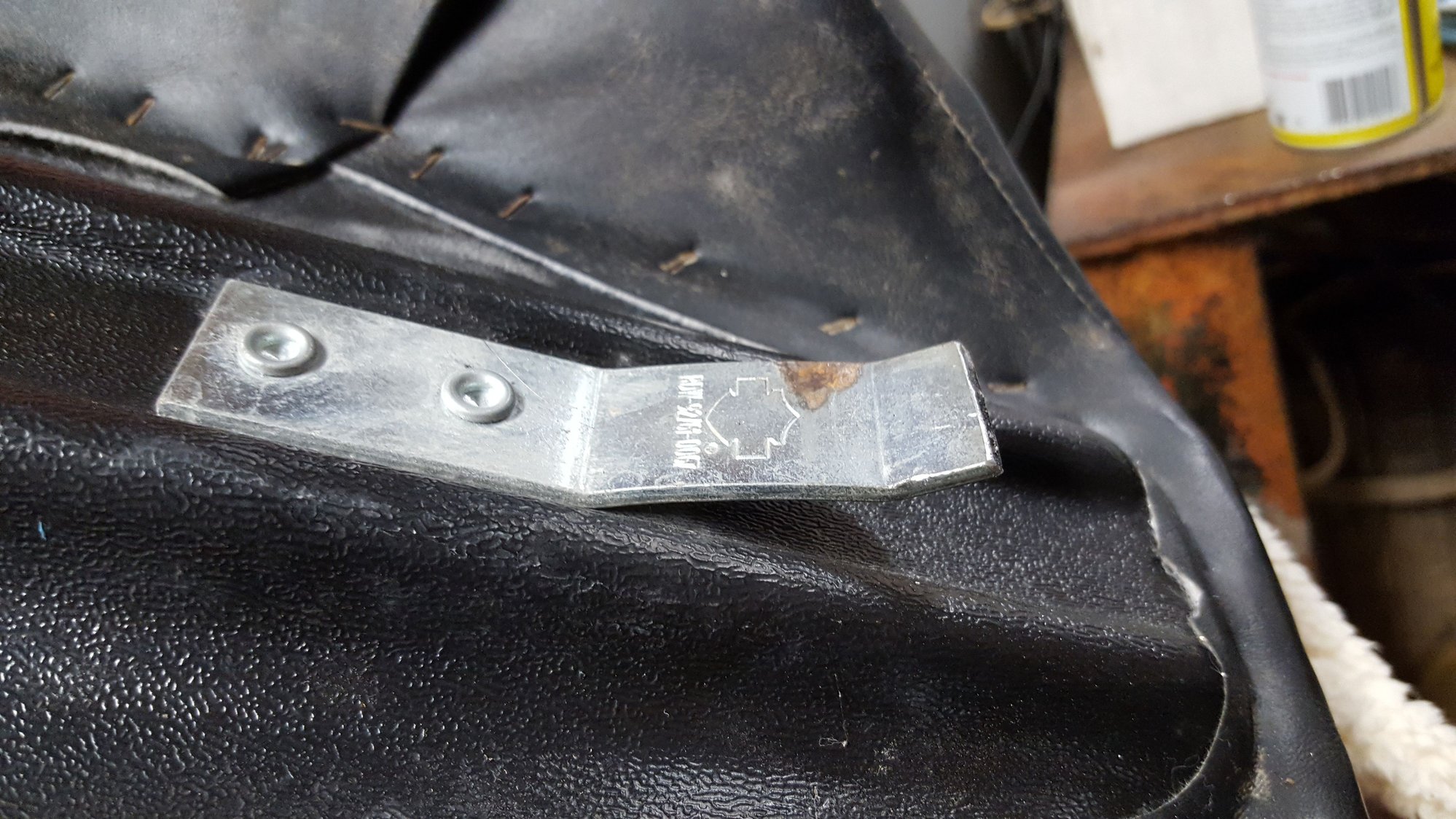

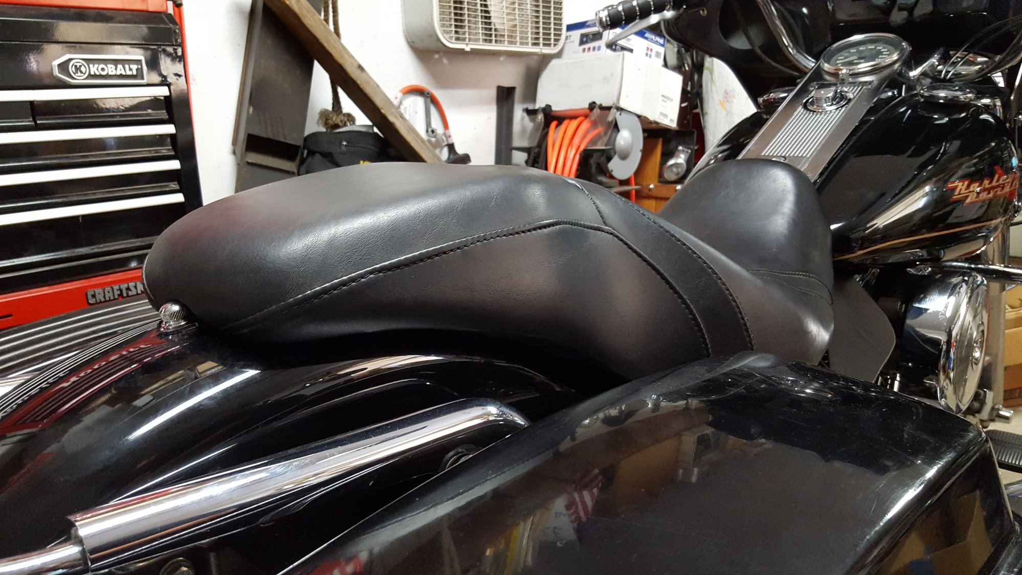

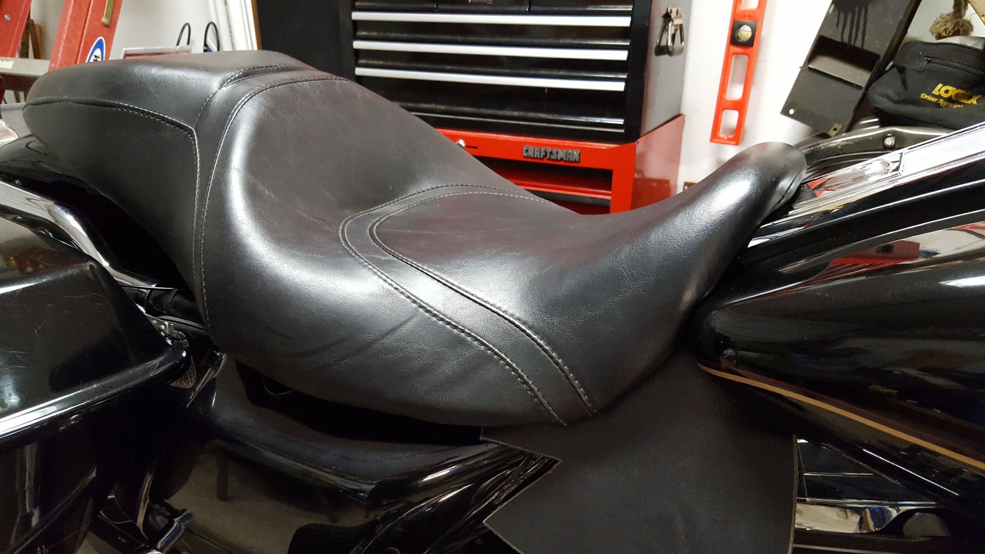

My 96 RK came with the original solo seat, p-pad combo.
The solo didn't work well for me. I picked up this 97- and up seat for a song and modded the tongue to fit my 96.
I cut the tongue back about 1", 1-1/4", then put a 8" crescent wench straight off the end of the tongue and bent the tongue back down towards the seat pan till the wrench touched the pan. Careful. Pan is plastic and pretty tough but it can crack. A file is great to knock the sharp edges off the cut seat tongue. Put the seat on the bike, wedging the modified tongue under the steel seat locating flap on the frame right behind the tank. The original seat fitted over this steel flap.
Don't cut the tongue too short, you want it long enough to fit under the steel flap tightly so that when you put in the rear fender seat bolt you're pushing the seat forward some to put that bolt in. This will hold the seat securely. Worked great. Fits great. Hope it rides great too.
