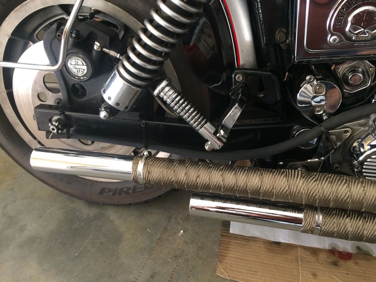

Old Jul 24, 2017 | 11:52 PM
monchidog's Avatar
monchidog
Joined: Jul 2016
Posts: 352
Likes: 81
From: Gibraltar
OK; just to finish this thread, heres a couple of photos of what i did using marine grade heat proof tubing. It's not pretty but i think it definitely works - any images anyone else has on on this to make it more subtle would be good. Now onto what to do with my crankcase seal leak or just bitew the bullet and tear the engine down...yikes!
Old Jul 25, 2017 | 05:34 PM
darylnj's Avatar
darylnj
Joined: Aug 2006
Posts: 177
Likes: 14
From: Freehold NJ
Default hose
no need to go back that far,drop it straight down between the trans and oil pump.if you are worried about oil on the back tire install a small filter.
it will never be noticed.
Old Jul 25, 2017 | 05:41 PM
apples402's Avatar
apples402
Joined: Nov 2013
Posts: 556
Likes: 40
From: nebraska
Almost identical to the way I ran mine, I just ran on side of swingarm instead of and and zip tied.
Old Jul 25, 2017 | 07:30 PM
glidein wide's Avatar
glidein wide
Joined: Jan 2015
Posts: 2,504
Likes: 150
From: ct
The things people do....keep an eye on that oil level for a while,an hell,if I works,go with it...certainly the long way to get there. If you're there....

Old Jul 27, 2017 | 04:30 AM
Yankee Dog's Avatar
Yankee Dog
Posts: 3,726
Likes: 3,071
From: Brighton, MI
No need for such a heavy duty hose either. Your first pick of your reroute has the hose dumping right next to your rear brake disk....not a good idea. Just run a simple oil resistant hose straight down like others suggested. Maybe an inch below the engine and done. YD
