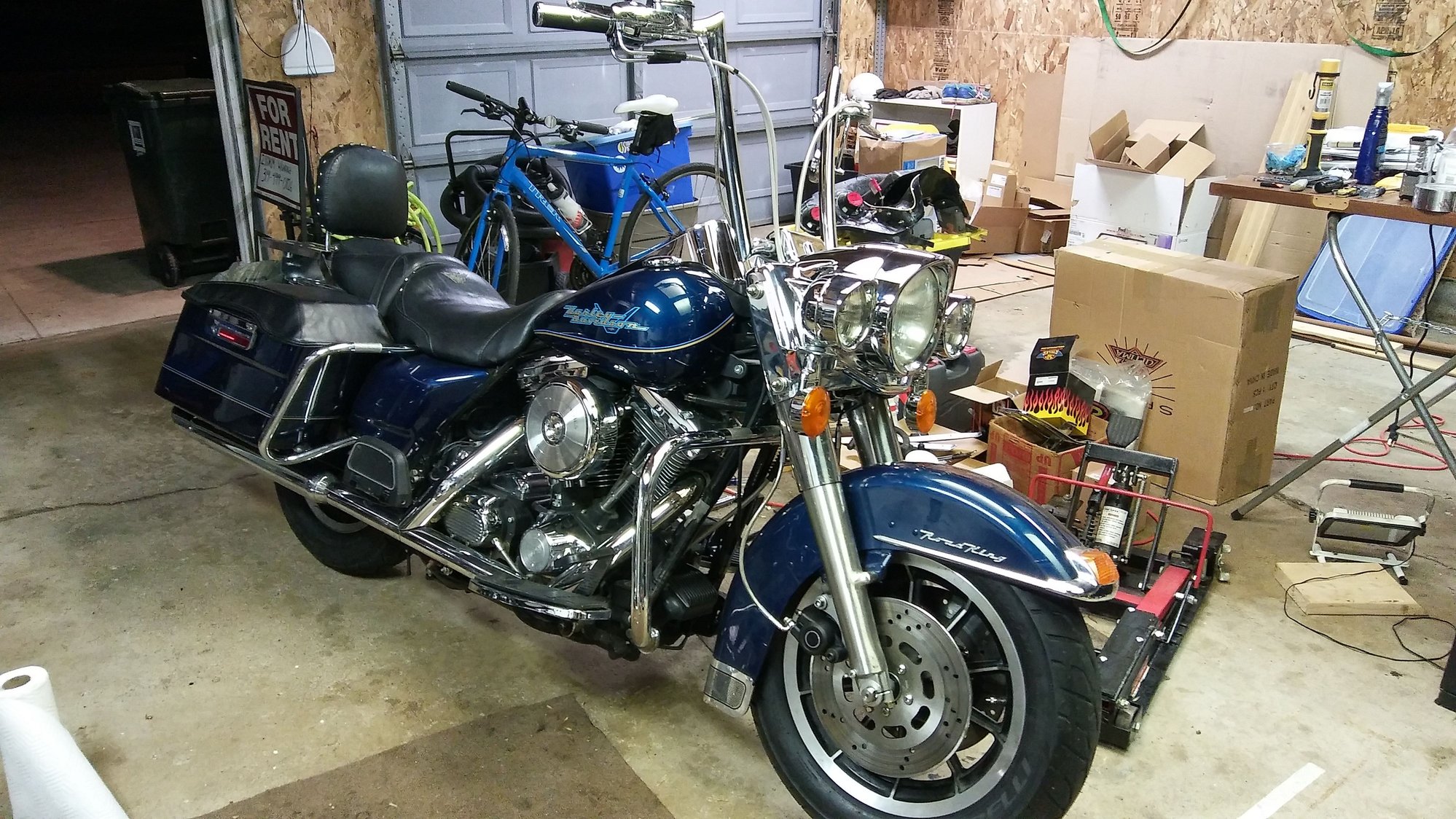

Originally Posted by Panheader
I guess i should have said the front wheel is turned slightly to the right when the bars are pointed straight forward. Been this way since i got it. Maybe previous oner hit a curb or something.
Once you get the axle in, the wheel is straight with the trees...the bars are crooked...common problem.
Replacing the riser bushings can help.
Old Jul 21, 2017 | 06:44 AM
Yankee Dog's Avatar
Yankee Dog
Posts: 3,728
Likes: 3,073
From: Brighton, MI
Rotate the fork tube while it is still in the triple tree and see if that changes things. Also put a straight edge on the fork tubes for a down and dirty rough check for bent tube. YD
Old Jul 21, 2017 | 10:34 PM
WP50's Avatar
WP50
Joined: Apr 2011
Posts: 6,186
Likes: 2,135
From: W. Texas
This is the most common thing to see.
WP
Old Jul 21, 2017 | 11:09 PM
Panheader's Avatar
Panheader
Posts: 141
Likes: 19
From: Evo-ville, Iowa
Thanks all, got it straight....loosened it all up, front forks, axle, fender, calipers, bars.....maybe more work than needed but its all straight as an arrow now.
