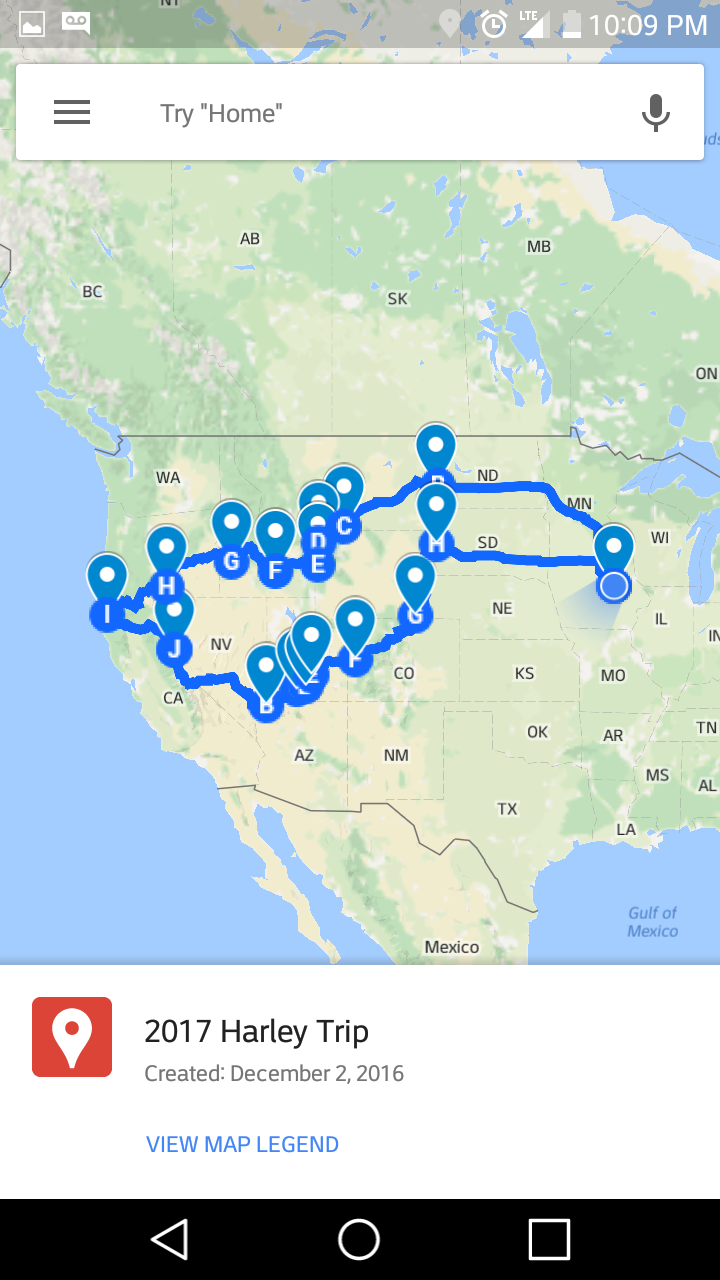

Gotta get it just right for this trip coming up!
