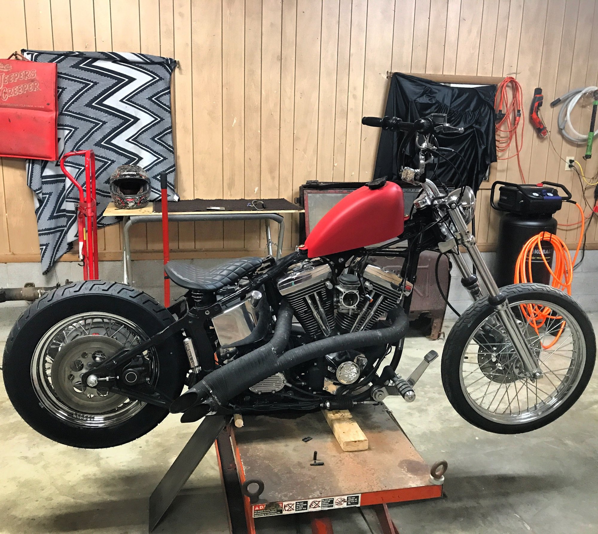

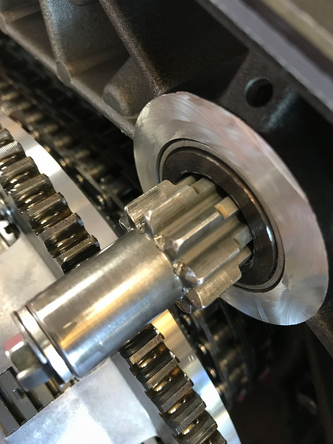

Hey guys, i got a custom softail with a 1340 evo only has around 8600 miles on it.. the motor is mostly stock other than a high flow filter and pipes.. im getting real bad kickback sound when i start when its hot. Sounds terrible. Ive been reading and seems like theres a million ideas on what the problem is.. also recently after all night riding it when i got home the battery was literally smoking or steaming and it was brand new. I have opened up the primary to install some custom mid controls and the jackshaft and started ring are showing signs of wear. Also primary chain was def out of spec and needed tightening.. wondering if that can cause the kickback? Any advice would be greatly appreciated.

From the pic of the pinion you posted...looks like a clearance issue from aftermarket parts...seen overseas primary castings do that...ring gear could also be suspect.
