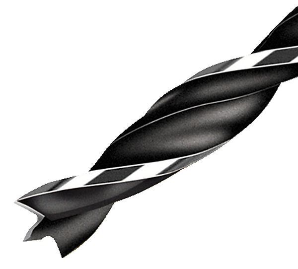

I have better experience using a wood drill type, rather than metal drill. Then try and not go all the way thru, but drill from both sides.
It's like cutting holes in glass, if you try and push thru, you'll pop the other side out and damage it.
You can buy special bits just for Plexiglass, Lexan, etc. They are not expensive but I'd say feel is more important. The hole also needs to be slightly larger than the bolt to allow for expansion.
This type. 'Plas Drills' are different, I've never used one.
