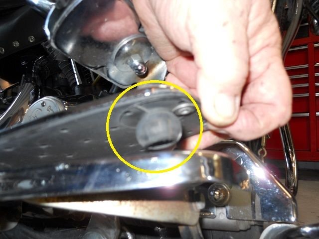

Some of the rubber bumper in two of the floorboard on my '93 Heritage Classic have torn and no longer connected to the bottom plate. Can these be replaced or are my boards trashed? I've checked online and don't see just the rubbers out there.

What your looking for would be called Floorboard Inserts.
I could not post a couple of links for some reason so do a search for
harley davidson flstc floorboard inserts.
Should get ya sumptin to look at
WP

Thanks for the replies but I'm not looking for the whole plate, I was hoping that jut the rubber part in the yellow circle was replaceable. But it appears that they aren't.
I have a couple extra if you need one.

The bumpers are molded as part of the floorboard mat and are not replaceable. You have to replace the footboard mats. They’re not too expensive and used ones can often be found on eBay.

Mat = Insert correct ??

The rubber part of the floorboards are replaceable ... you can get them from a dealer for around $35 a piece, the same board fits both sides ... unless you have the fancy ones then they are more ...
