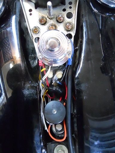

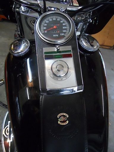

I use one on my '93 Heritage Classic and it's great. It's coded and programmable. Unfortunately the link to the guy that makes them has gone dead.
