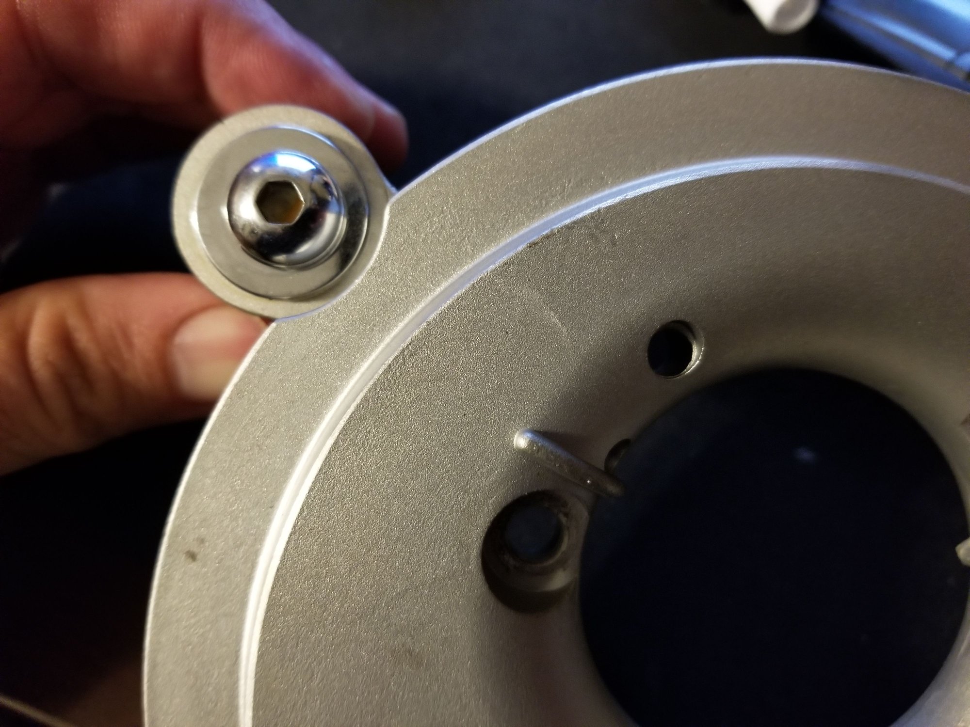

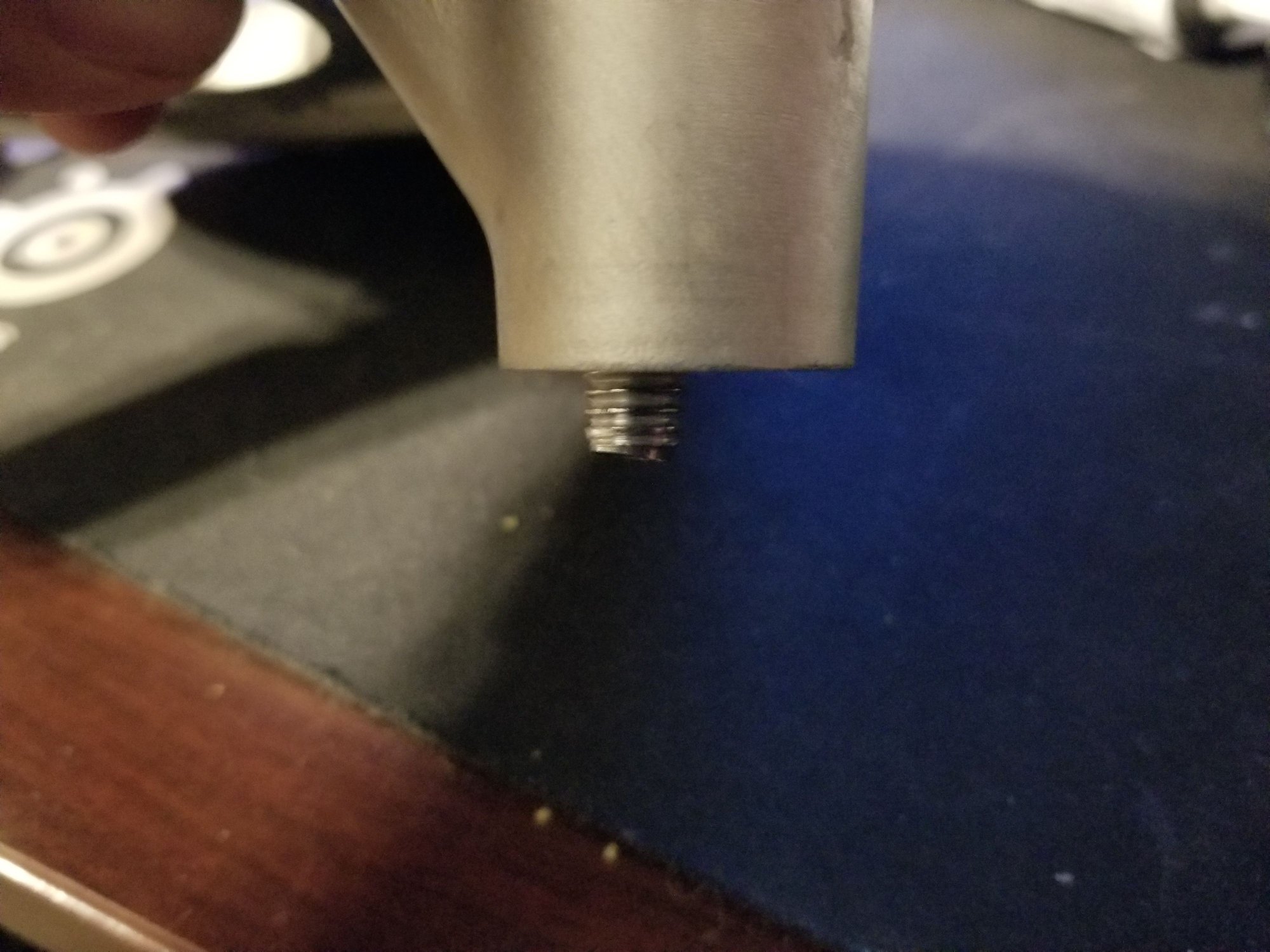

I put a Big Sucker on my 91 FLHS. All I did was was get some nice button head cap screws 5/16"-18 x 2" long. Also a fender washer and lock washer. It fit perfect for me. You do have to hold everthing center when you tighten the bolts.I have it apart right now for a huge makeover, so I took a few pics of the bolt. Sorry for the picture size. I haven't figured out how to resize them yet. 2 inch was barely long enough. They didn't have 2 1/4 or I my have tried them.

Thank's Don, appreciate your help. Then I know I can use the Big sucker.
