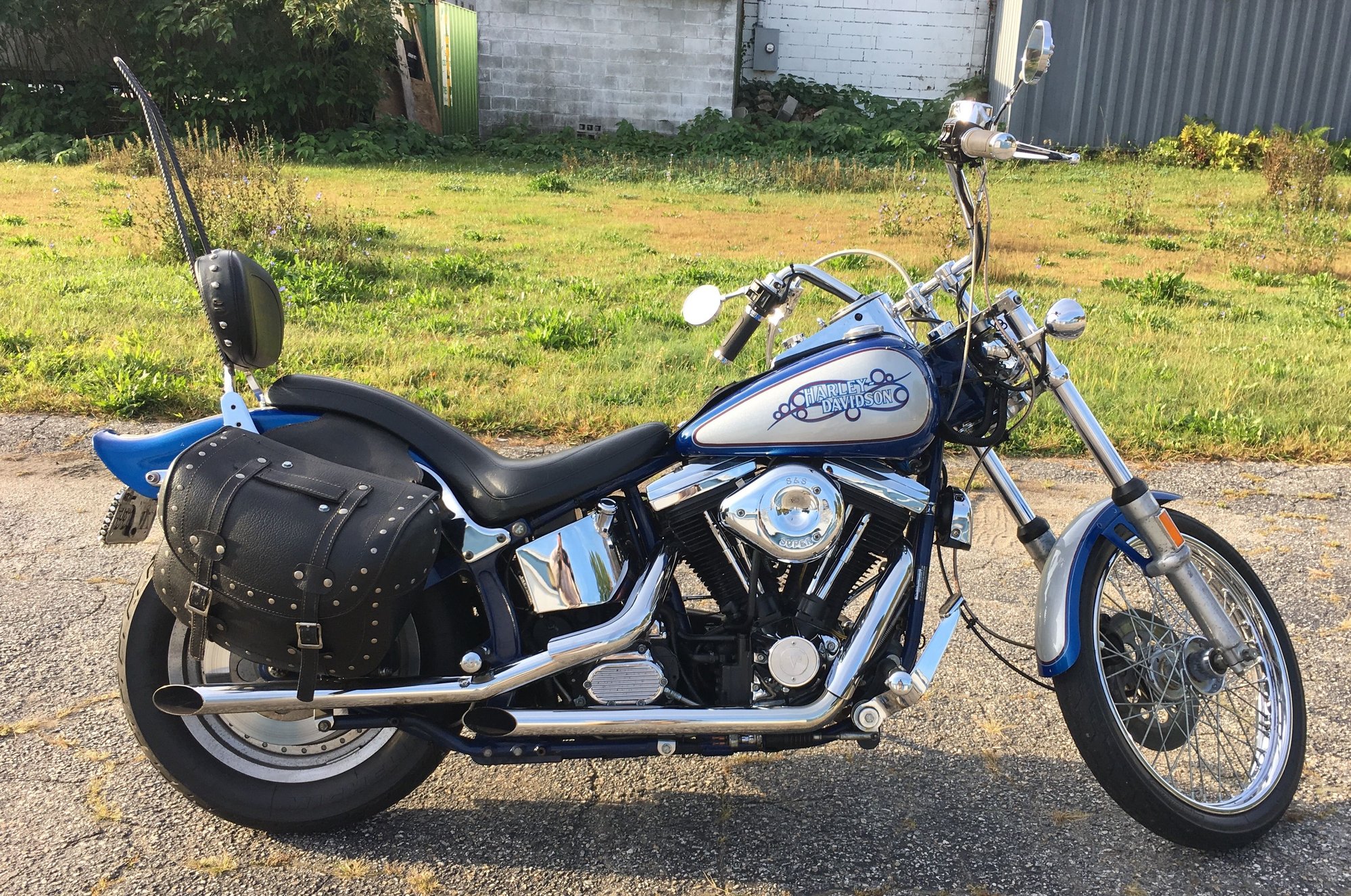

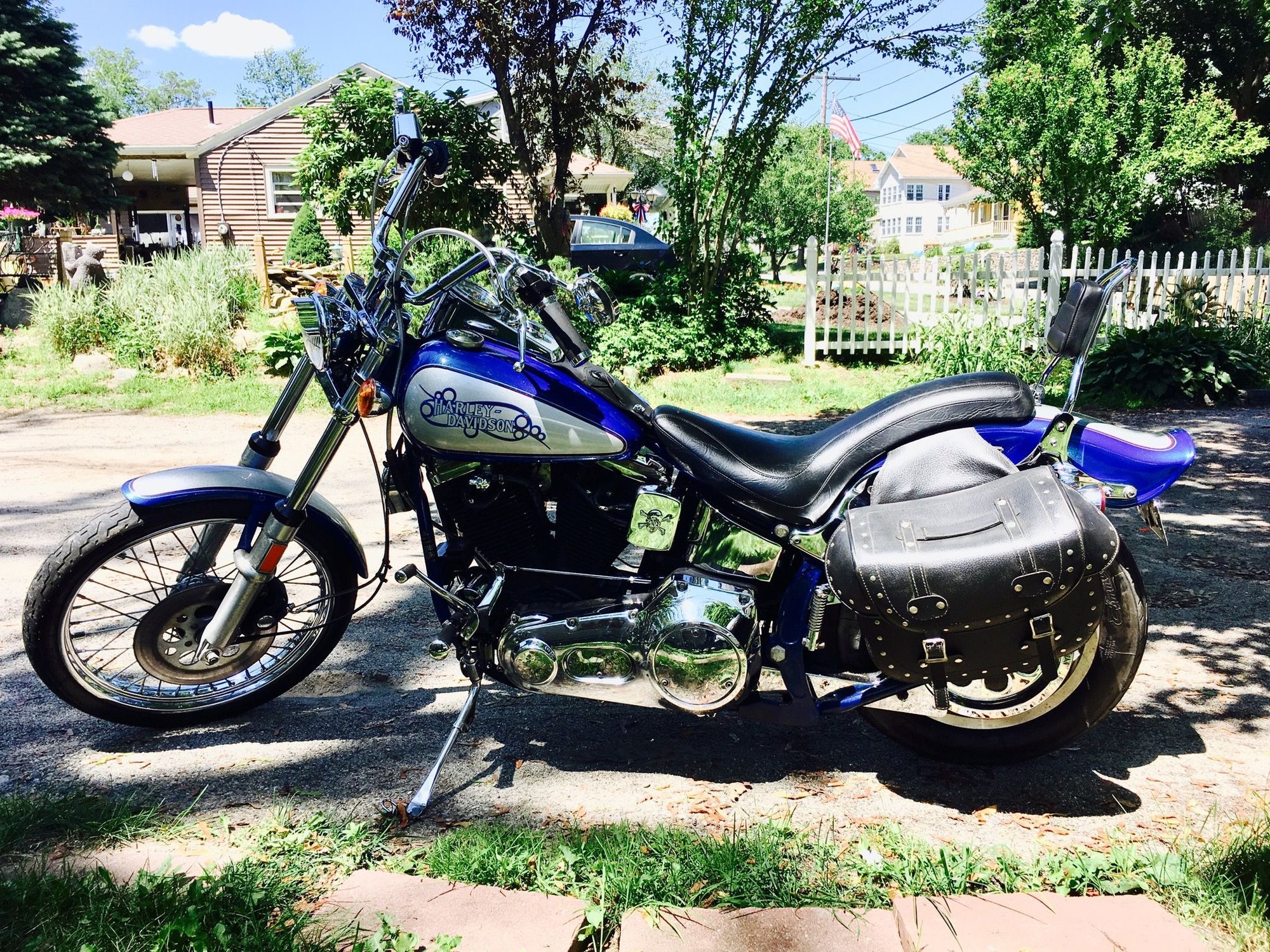

Good to know! And I will definitely take you up on your offer if I run into any other problems that I can’t figure out. I’ve attached a few pictures. I absolutely love this bike. Nice step up from my old Sportster.

Good looking scooter man! Love those Evo's. Heres a pic of mine.
