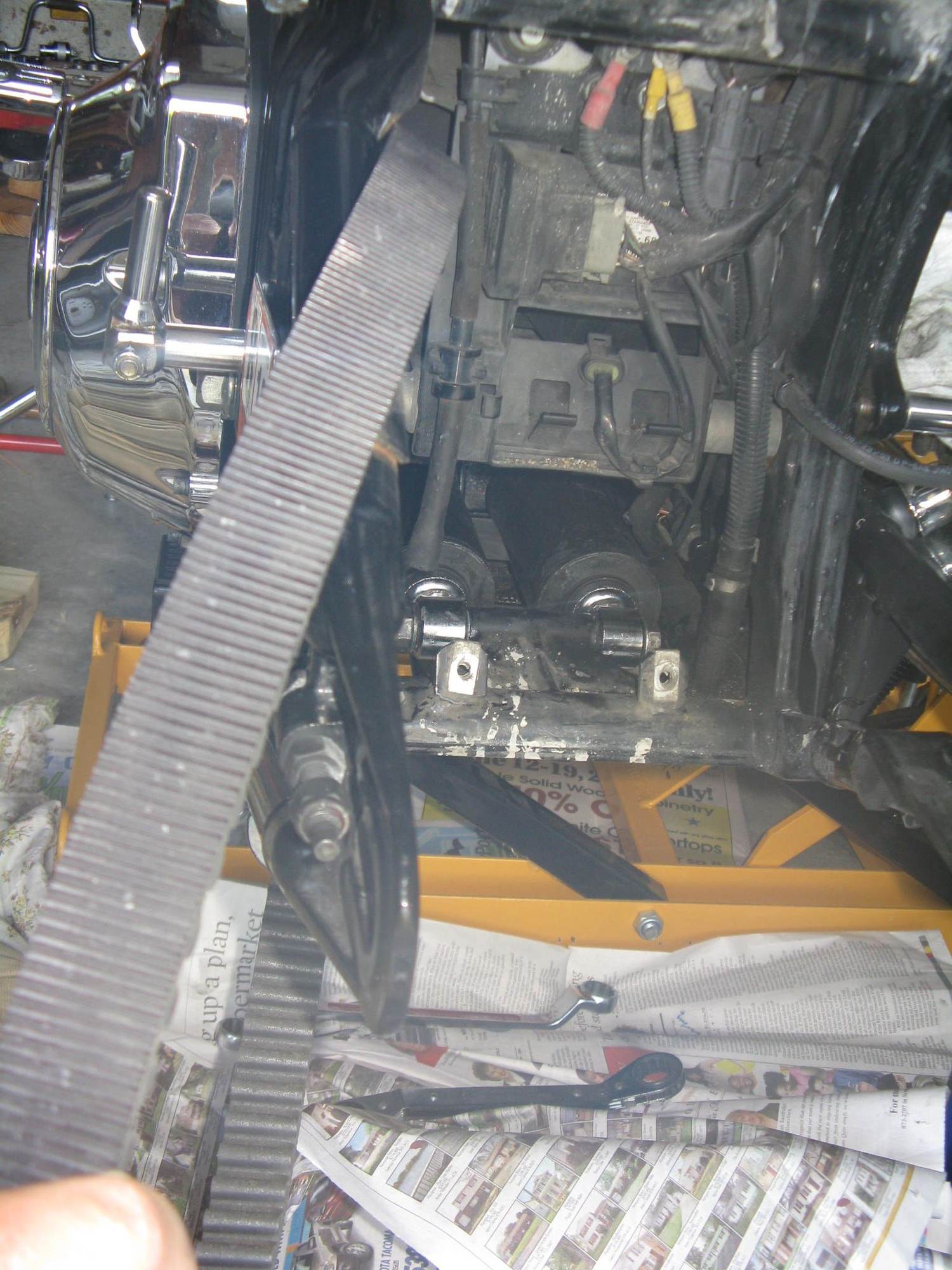

I check my hose coming off of the top right side of tank. It’s cracked in several spots. I’m going to replace tonight. So there should be a check valve on the end. I’m guessing it’s to let air out?

From: Honah Lee
Mine has the check in the end I think. You can see it just above left shock in the line. If your line has cracks, ever time you have a full tank and brake, gas is coming out of those cracks and falling on top of the motor. You have a bomb with a slow fuse.
