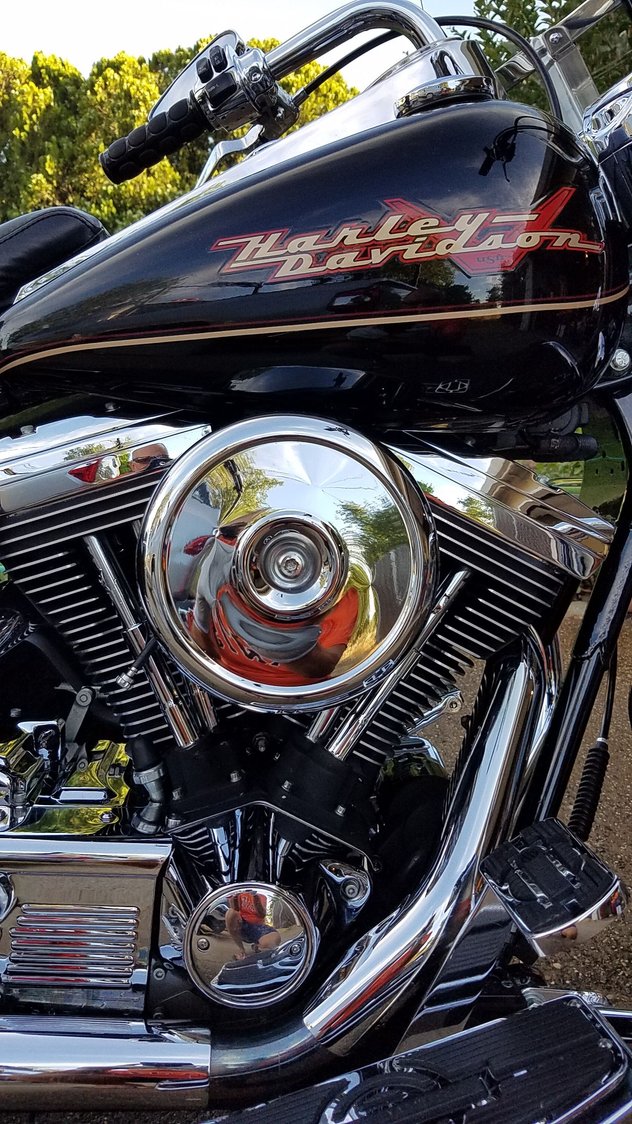

Just my opinion but I think that black tank with the HD script is one of the best looking tanks of all time. Will be interested in how it goes.

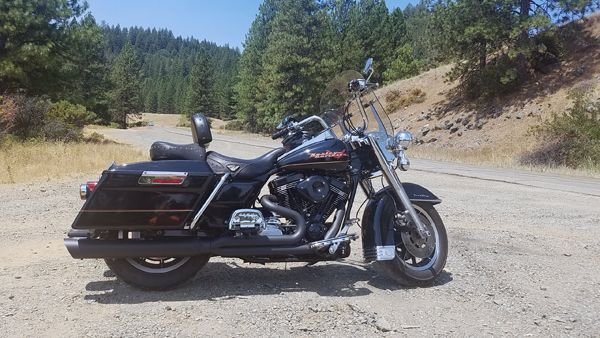

Got the S&S V111 in. No problems, runs great. Still breaking it in. Did the initial 50 mile break-in by the book, then changed the oil and filter. Put another 400 miles on over the weekend, so I will be changing the oil and filter again soon (500 miles). Then once again at 1000 and it will be broken in. Experienced the rev limiter kick in (Super Stock ignition) a few times over the weekend. I think it's set around 4,250 rpm. I also got a D&D 2 to 1 with the quietest baffle.

I really like the gloss black (powder coat?) covers!
If she runs as nice as she looks... home run, touch all the bases!

Love the look,enjoy your "new" ride !

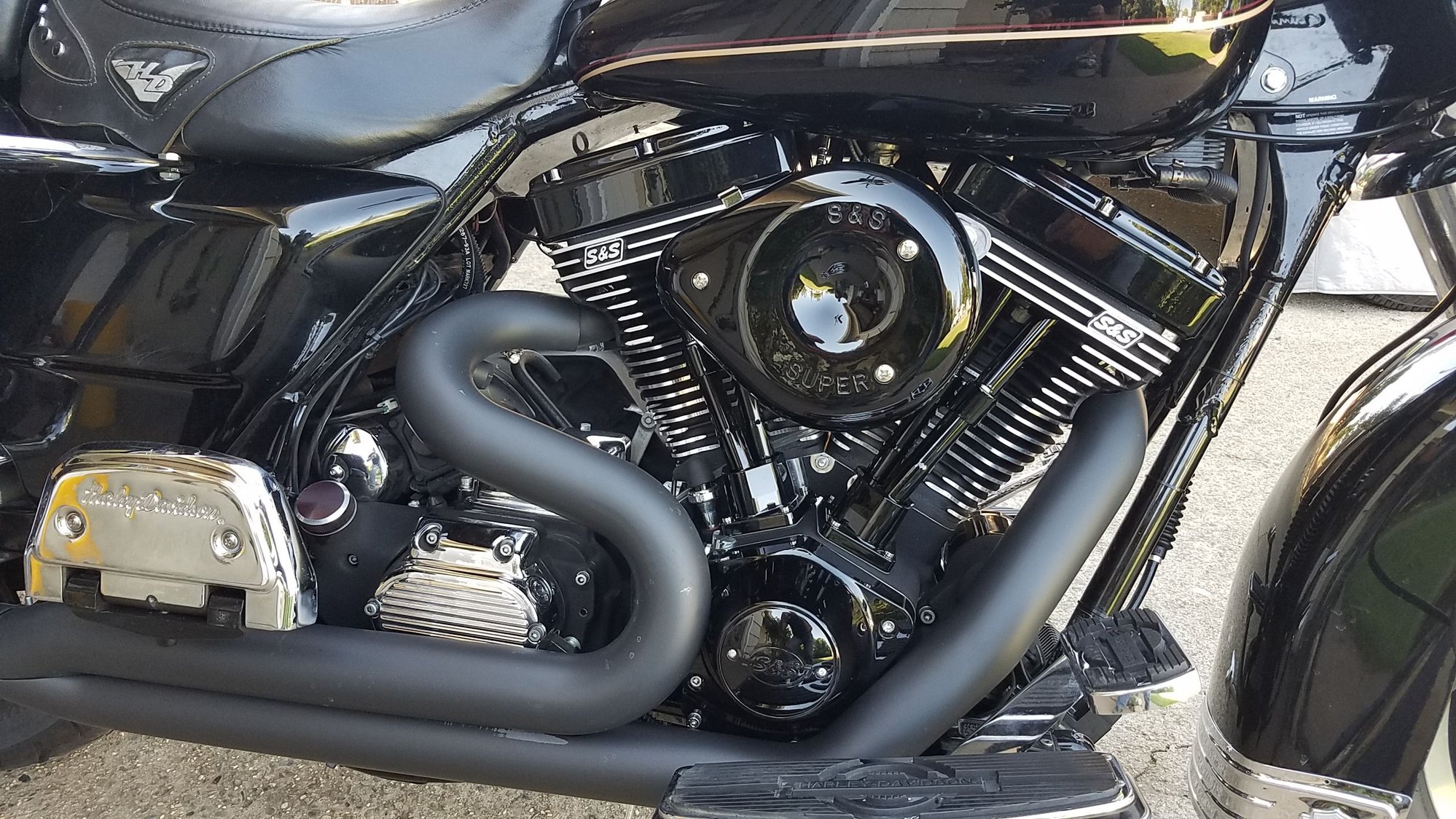

The SS 111 is on my list of things to do. Everything I've read about it is fantastic. That black chrome is the way to go. Looks like there is more room between the frame and engine.
I'd rather have a updated modified Evo Road King over the new models as well. I just need to get mine up to that point.
