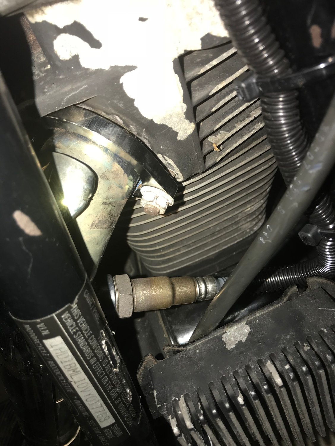

Do you have pictures of this item mounted on your bike? I assume a bracket needs to be purchased in order to mount? Going back and forth on this as it is a $450 - $500 purchase (vs. the AEM AFR gauge that is ~ $175) and I understand the info that can be gained with data logging.
https://www.hdforums.com/forum/evo-c...fr-s-o-my.html
This is for the Wego lll.
Here’s a link where I made a bracket to mount mine to the handlebars.
I think most zip-tie theirs, but I have access to material & machinery to make my own.
