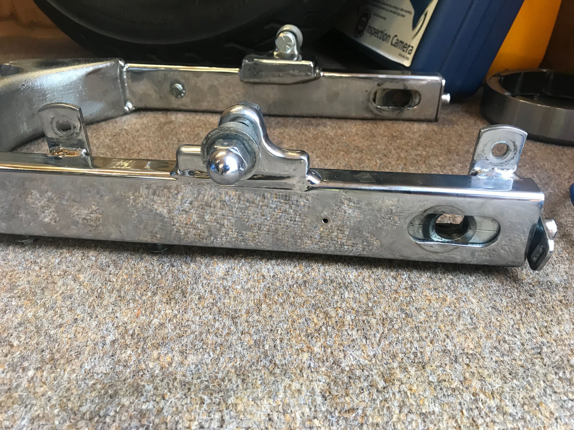

While you're at it check the square tubing at the axle slot for cracks or a sign that it's been crushed\misshapen\cracked. If it is you might want to attend to that before the bushings.
sorry what part buddy?
daz
He's talking about the two rectangular sections that extend back from the pivot. The ones on either side of the wheel to which the axle and shocks connect. There is a tendency for those to crack.
this part boss??
