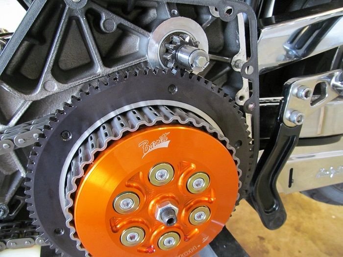

What it is doing is, it will most of the time engage perfect and instant start up. BUT, Sometimes it does not engage at all and just grinds. I pulled off outer pri cover to see exactly whats happening and the 2 gears have to be forced on to each other. Its like the ring gear is too tall and the pinion runs into it.
Also this is my second new starter, both do the same thing. Just installed a new HD starter.

I have to lift up on the pinion to get it to mesh on the ring

The bushing in the primary cover supports the pinion, the pinion has some wiggle room, check the fit in primary cover just to be sure nothing binds, over tightening the center bolt seems to jam stuff up too, just snug it, drop of red locktite and with the lock tab, it wont come loose.

Yes I checked all that and so did my Indy. The pinion bolt is finger snugged then tightened to first flat so tab will hold it. Thanks I appreciate your input.

I hope the new ring gear works for you, when you get the new one, and the old one off, put them on together and see if any visible difference, let us know what you find.
