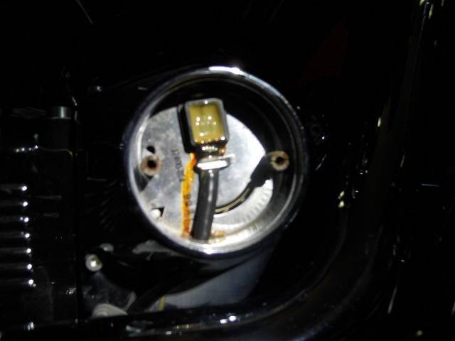

Shortly after I got it a couple of years ago my 93 started running rough and skipping a bit but didn't quit all together. I opened the timing cover and found this.
I replaced it with an after market sensor and have lived happily ever after.
