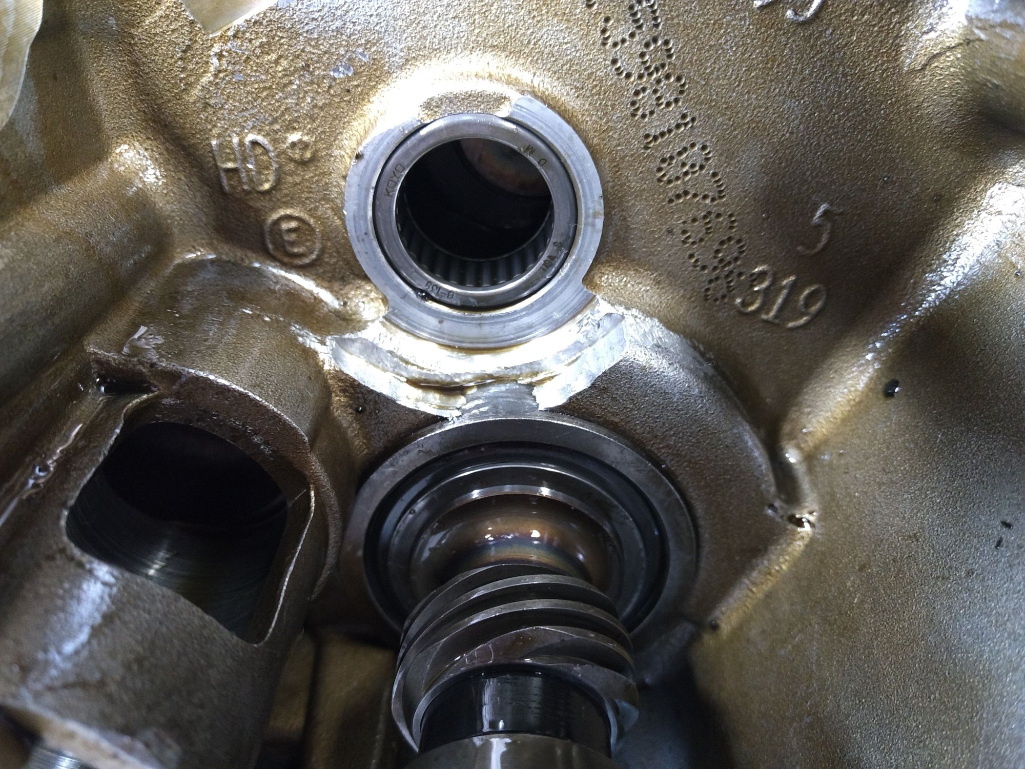

So I checked a couple of more thing's this morning to make sure I didn't have any issues once i start the swap... Checked the cylinder spigots and lifter blocks.... All that seems good. Also checked the S&S steel breather and I thought that fit was perfect.... The new case comes with the Koyo B-138 already installed and a Timken for the sprocket shaft. I also like the fact the the case has a drain plug in the bottom, just incase it does sump after a long sit, I'll be able to drain it... Most likely I will be using the bottom breather as well...Another thing I did notice (that I never caught before) clearancing the case to accept a lager lift cam. I didn't realize that it was necessary to remove as much as my builder did. When I first looked at my case on the bench, I said WTF.... check the pic... I thought it was way too much but apparently S&S does the same for the Evo cases to accept up to a .650 lift cam... I have to question whether or not it's a structural issue but after noting the S&S case, I guess it would still be a solid fixture for the pinion shaft bearing.. Moving on, I'm still looking for a good lifter that won't pump up and smack a piston... If anyone has any Ideas, I'd love to hear them... Thanx...
