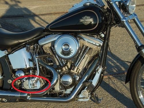

Just got the baker kicker conversion for a evo on my 1998 softail , any idea what exhaust will fit. I called baker they were of no help

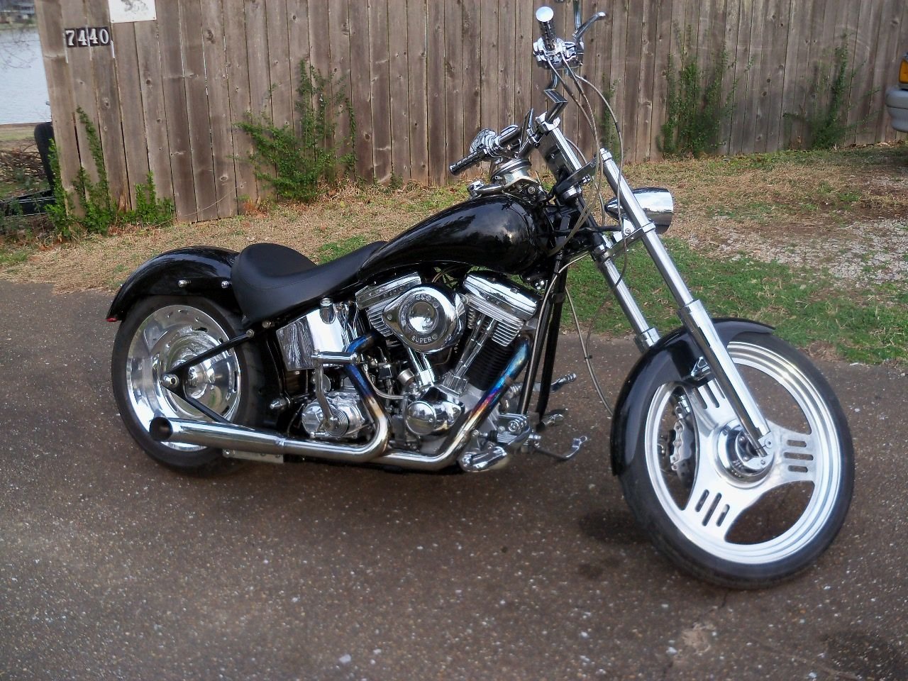

Exhaust advertised to fit 84-85 softails should fit...many exhaust that say they only fit 86-99 softails will fit...many 2 into 1's will fit...
Many exhaust will require a extended kicker shaft, or offset kicker arm to work...
Look at as many pictures of bikes with kickers to get an idea of what fits...

There are tons of "off the shelf" exhaust that will fit with a kicker...when you look at pics of exhaust just make sure they don't run across the transmission cover...many do...
