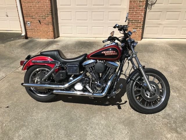

I have a 98 Dyna convertible with just under 30k miles that I picked up a few years ago; I really like the bike but its performance has always been underwhelming.
So after some research here and elsewhere I was inspired to improve upon that and installed an HSR 42 which changed the whole personality of the bike.....it's actually been more fun to ride. Shortly thereafter I noticed an oil sheen was burning & smoking on the rear exhaust header. Upon closer inspection, I think I may have a leaking head gasket.
Bike seems to run fine and is firing on the rear cylinder, but I see a slight puff of smoke coming out of where the head meets the jug. So I guess I'm surprised that the rear cylinder is actually firing because I thought a leak would cause the compression stroke to be non existent due to the leak.
So,will I cause any damage to the motor if I continue to ride the bike with this leak?
Also curious what would be the likely cause of this? Rich or lean condition maybe?.....Riding the bike a bit more aggressively?......oil too low or too high?....valve issue?.....ring issue? I have looked through a lot of threads but couldn't really find anything that clears this up for me.
Bike also has a weeping base gasket on the rear jug so I figure on replacing that too when the time comes for the top end to come off. And when that happens......well, more money, more money, more money! But just did my taxes and it'll prob be a little while before I can get to pulling the bike down. Thanks IRS.
thanks for any insight
when I picked her up....
as she looks today....
