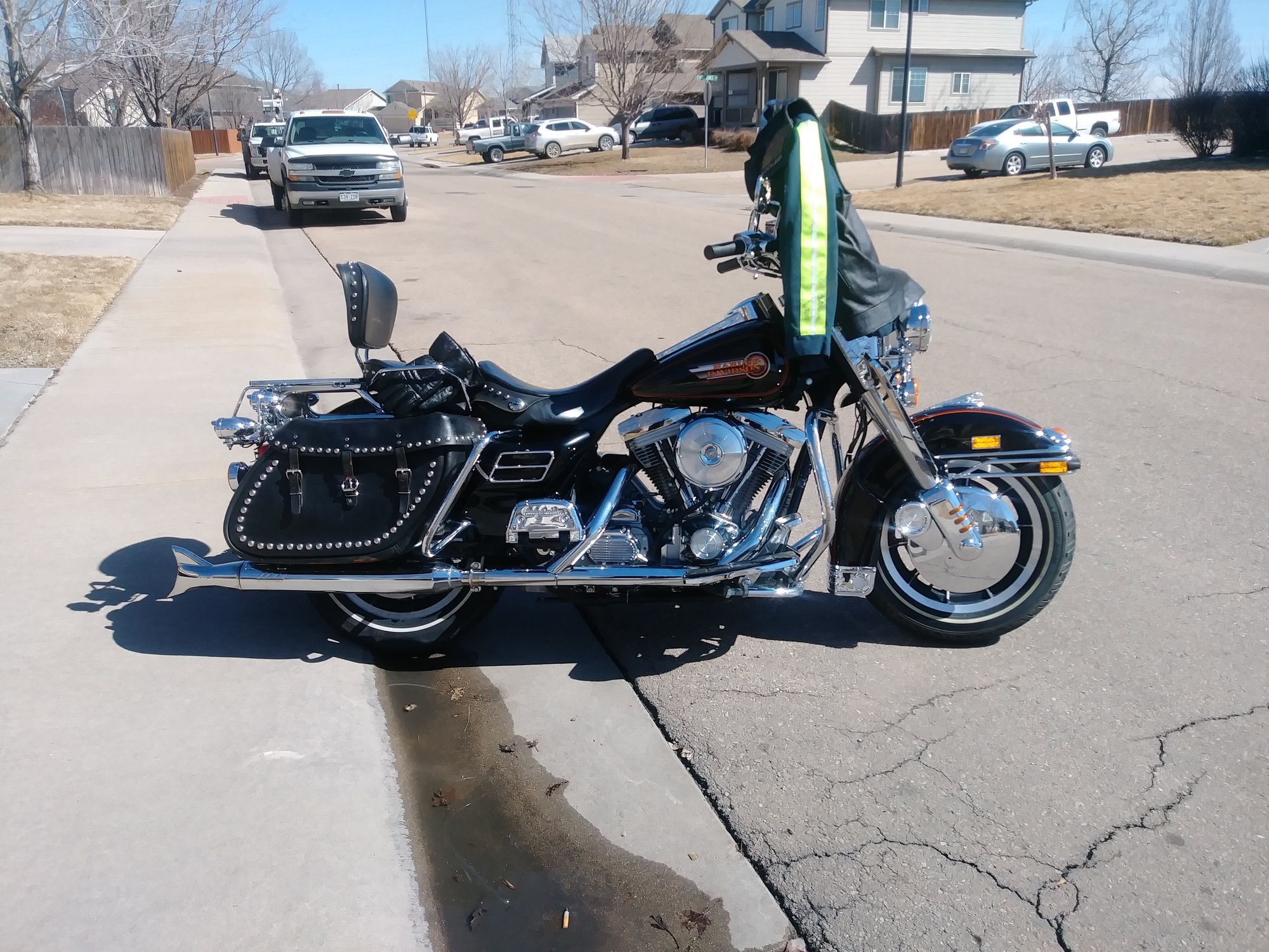

I have a 93 flhs with supertrapp pipes and fish tails ive done research on how to make them louder. But it hasnt worked so I took them out is this a good thing or bad, but it shire dose soind nice.

Its been 2 weeks now with out havent noticed any difrence in poformance or lose of power. How bout just removing the wrap and putting everything back in? All my plates are internal.
so even if I remove the fish tails you can't see the 18 disc I have put on.
