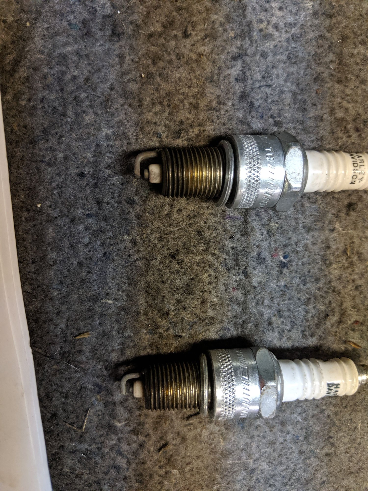

Going back to the stock needle after work today. Not sure if it's over fueling. Adding a pic of the plugs after about 50 miles mixed riding.

Blue smoke is indicative of burning oil. Black smoke would be indicative of too much fuel. Do a leak down test on the motor. The spark plugs don't look too bad, top picture shows the ground electrode eroded.
