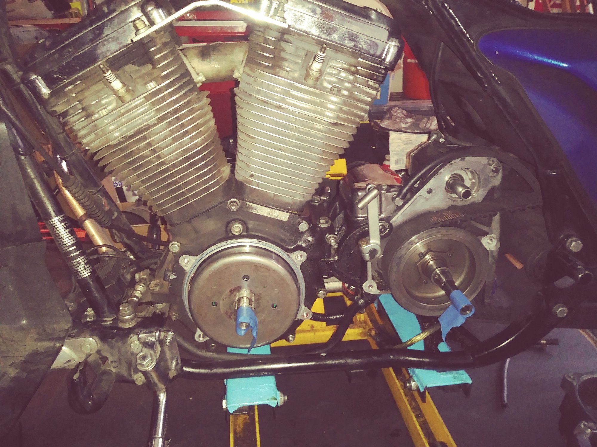

Thanks for the replies guys. I went with the milk crate method, and it worked great. Very sturdy, so much, I forgot to strap the bike down. Had to jack the lift up highest, slip in the milk crates, and then release pressure to rest onto jack's locking mechanism. Here's a pic. I'm going to replace all the oil lines and flush the oil tank, since I'm putting in a fresh engine. This old bike needs new lines anyway.

Thanks. I replaced those two years ago. Still doing great. You can see in the 1st pic, I don't have the locking plate on the old '89, so I put in another bolt. It was been working fine. Not going to fix it if it ain't broke.
If that nut starts to back off, it will shear those bolt heads off easily, that`s one or the reasons for the newer pulley configuration.
I would consider that old `89 pulley configuration "Broke".
I can shoot you a parts list for the upgraded setup if you would like.
