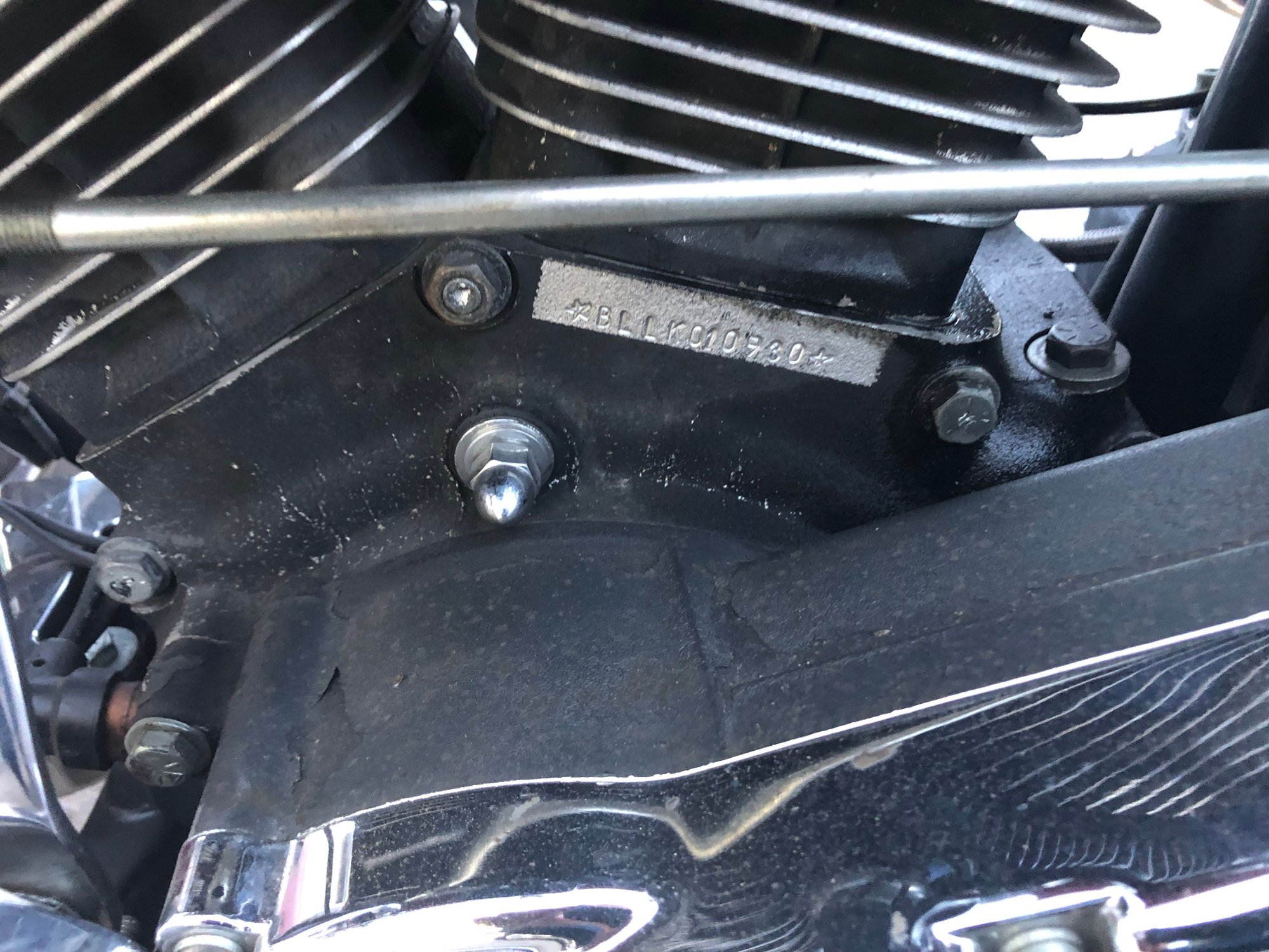

Looked at it again. Case is stamped - *BLLK 010930*

Yes, the cases are 1989, but as long as the title matches the VIN on the frame, that's the important part. And you can see rear cylinder has the base gasket leak. This is common and can be fixed. Look for the cracked described in other comments. For 1989, ask about the fluid levels in oil and primary. You can't really check a loose case insert unless you tear the engine apart. Bottomline if frame and engine numbers don't match, $4,500 is too much. I, personally would offer $3K, and would walk if no deal.

Thanks for the replies. I appreciate all the information. The local guy that’s been doing this for 55 years said that’s one of the best years in his opinion, 1989 for EVO. Anyway, he said get it, keep fluids changed and ride the s**t out of it if you like it. Anything mechanical will need work eventually. I’d probably be reading my 1999 FLHTCUI that I’m not real fond of for it. But that might not be smart either ... lol.
I did did talk to the other guy that owned it for a year before current owner. He said it had been built when he bought it. And that’s all he knows.

If it's been "rebuilt," are there receipts for it? And what exactly was done? Your old timer friend is probably referring to '89 having the 5 piece crank that engine builders like, but that's just preference. It has been documented that 89-92 cases have issues. Will you have one? Maybe or maybe not. He's right, everything is going to need fixing eventually. :-) Ultimately your decision, good luck.

With a leak that bad at the base gasket, I w pills suspect a pulled stud... be careful...
