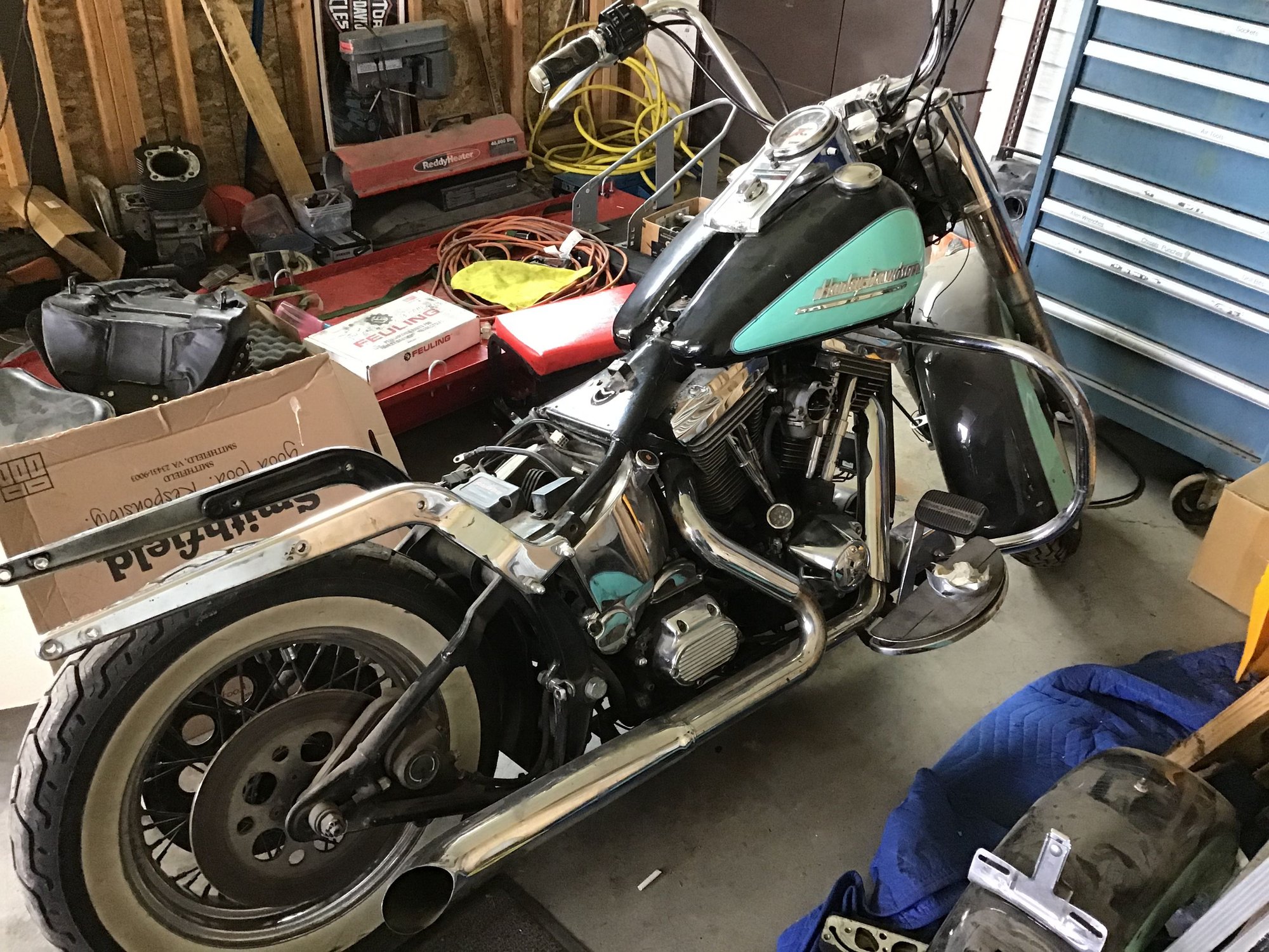

This is the bike I took in on trade for the engine work

Nice trade. Looks like it's close to road worthy.

Great lookin bike,nice to have one to tinker on.

Looks like its close to a rider

S&S E, wonder what else it's in it.... How's it run? Looks good....
