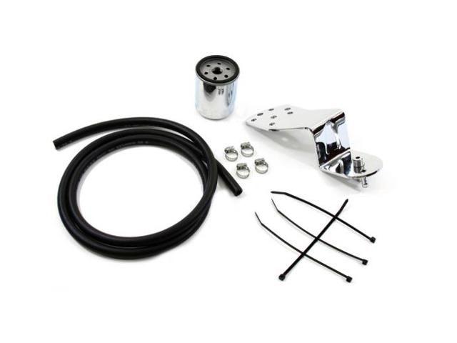

The oil filter mount on the early Softails is on the front downtube (the best setup the factory ever used).
Engine is a direct swap.
Mounted to the left peg mount...mine had cracked and been brazed twice when I obtained it...not on my list of "best"...obsolete from harley...v-twin makes a repro.
I should have said "On some of the early Softails".
I think the mounting boss welded to the frame downtube may have started when they started making a Softail model with footboards.
