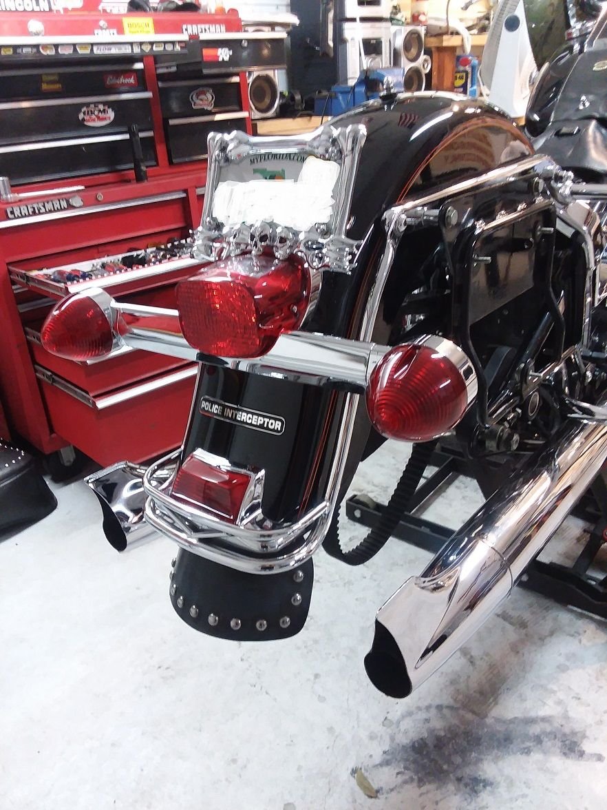

So I finally got the *** end of my '93 Heritage all back together after removing the swing arm to dig out the broken shock bolt. Now I'm just waiting on another new tire. The one that came in on Friday was a blackwall instead of a WWW and since the shop is closed on Mondays I'll have to wait 'til Tuesday to get it mounted on the rim. Then I should be back on the road if all goes well.

What happened to your license plate !
