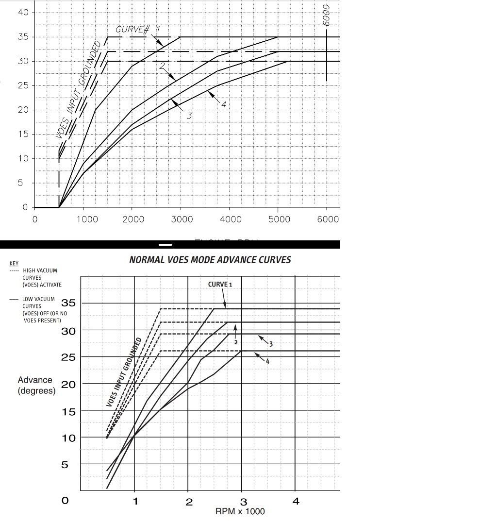

If you end up noticing some pinging, don't blame the cam. The ultima has a pretty fast advance rise when compared to the dynatek. If you cant tune the ping out, then consider reprogramming the ignition using one of the dynatek 2000i curves.
I hope you don't have an issue, but just a heads up if you do...Dynatek curves are the top graph, Ultima curves is the bottom. I am running the Dynatek curve #3 with a VOES set at 6 and the bike loves it. YD
Yankee dog, I'm actually running it on the curve 1 setting n it shows no signs of detonation or pinging. Its smoother on curve 2 but it really pulls on curve 1.
