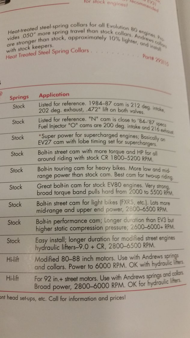

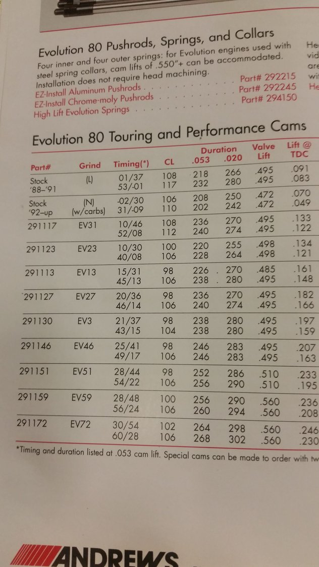

If you want ths skinny tween the 13 and the 27 call Andrews 847-759-0190. I have n can save u some time. Either one is good they're nearly identical, 99% of the population wouldn't be able to tell the difference is what the tech support staff told me, your doin too much hand wringing.
Figure out where you spend most of you time on the tach n choose accordingly. If you see my post above that's why I took the 13 over the 27. I run a Dyna superglide at 536# a light bike n should probably have the 27.
2 parts same page. Match the cam by counting down.
