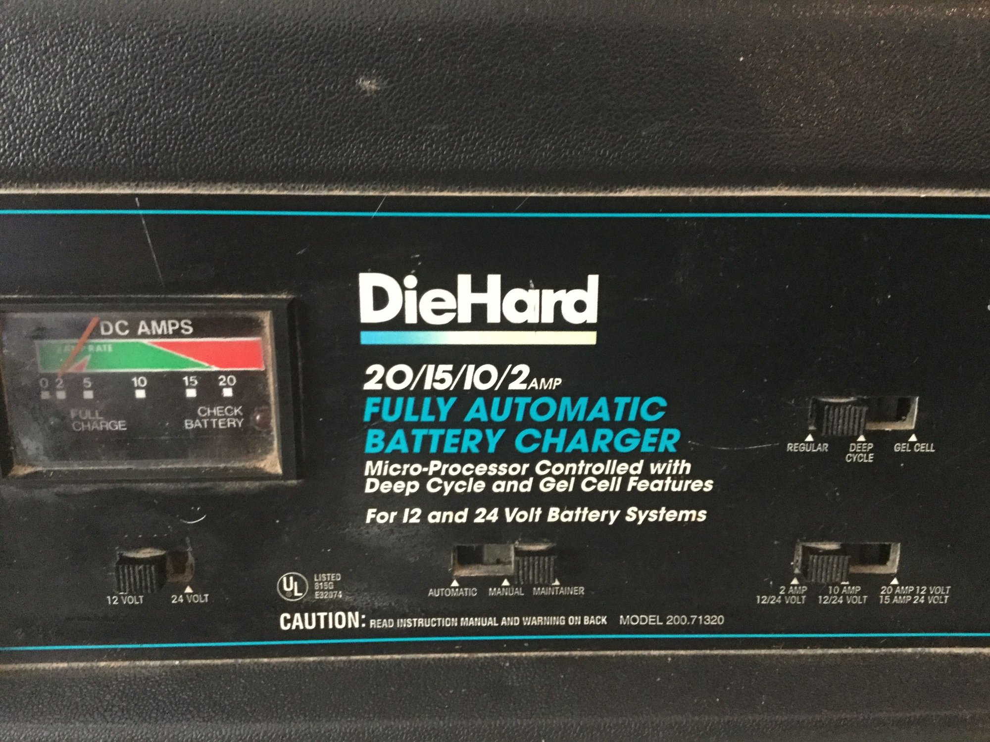

I’ve never had any of my bikes on a trickle charger, I ride all year around, I now have two bikes and I had this old charger sitting around and it’s got a few settings, I would like to know if this is the correct setting to trickle charge. I have it on regular, maintain, and 12 volt 2 amp.

If you must use the one you have, the settings you have shown above are probably correct. Other comments:
>A gel battery is very rare. Most motorcycle batteries today are AGM types (Absorbed Glass Mat).
>The lowest setting is recommended. Most true motorcycle "tenders" charge at a rate lower than 2 Amps. Mine (like the link) charges at 3/4 Amp to avoid heat buildup. Note that these also have an in-line fuse which is a good safety idea.
>The "maintainer" looks function like a "tender" but does not have the fuse.

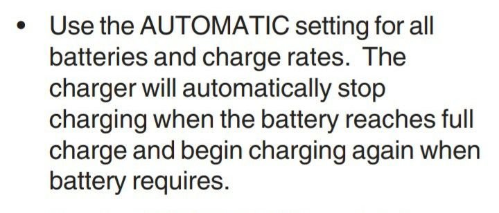

What makes you think the OP's device isn't modern? It's controlled by a micro-processor.
According to the owner's manual.

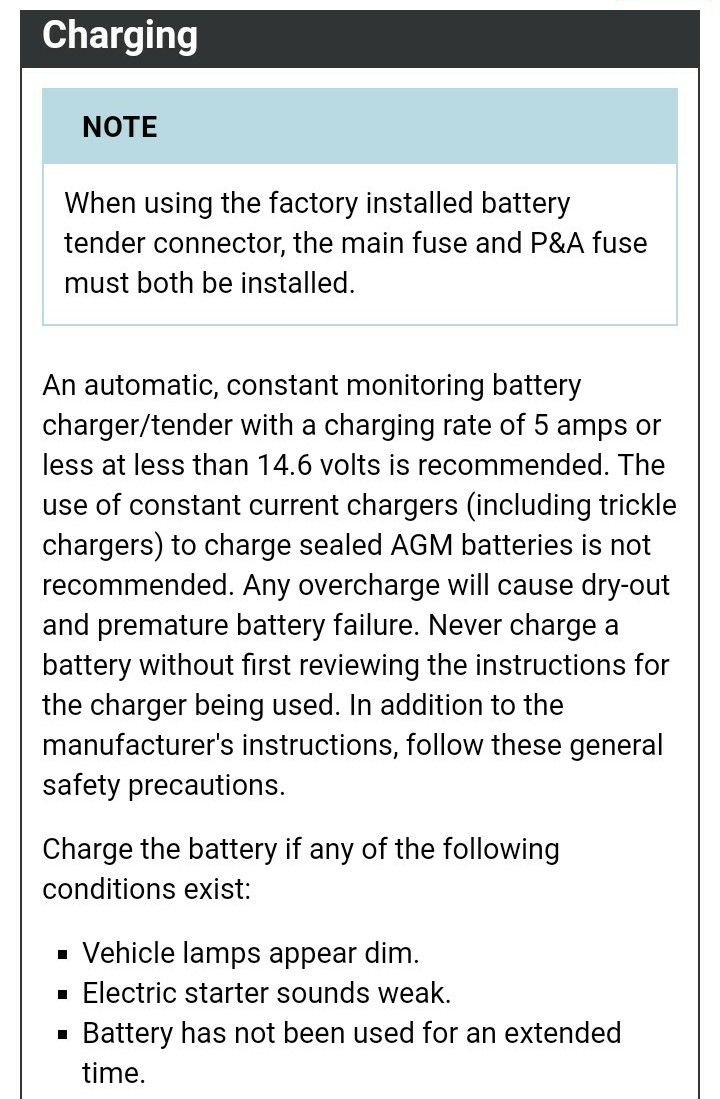

My 2018 Touring Models Owner's Manual recommends 5 amps or less.

According to the instruction sheet listed above, it seems clear to me that for sealed AGM batteries, a tender is the best snd safest choice. Not a charger or a trickle type.
