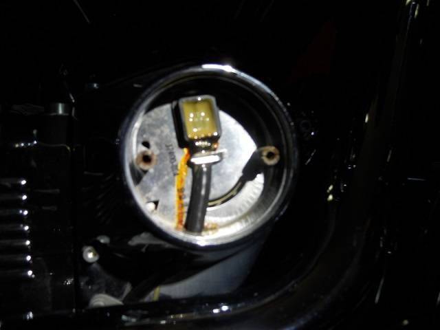

Hey Man's Avatar
Hey Man
Joined: Jun 2015
Posts: 10,302
Likes: 7,780
From: West Central FL
If you sensor looks like this that's a problem.
