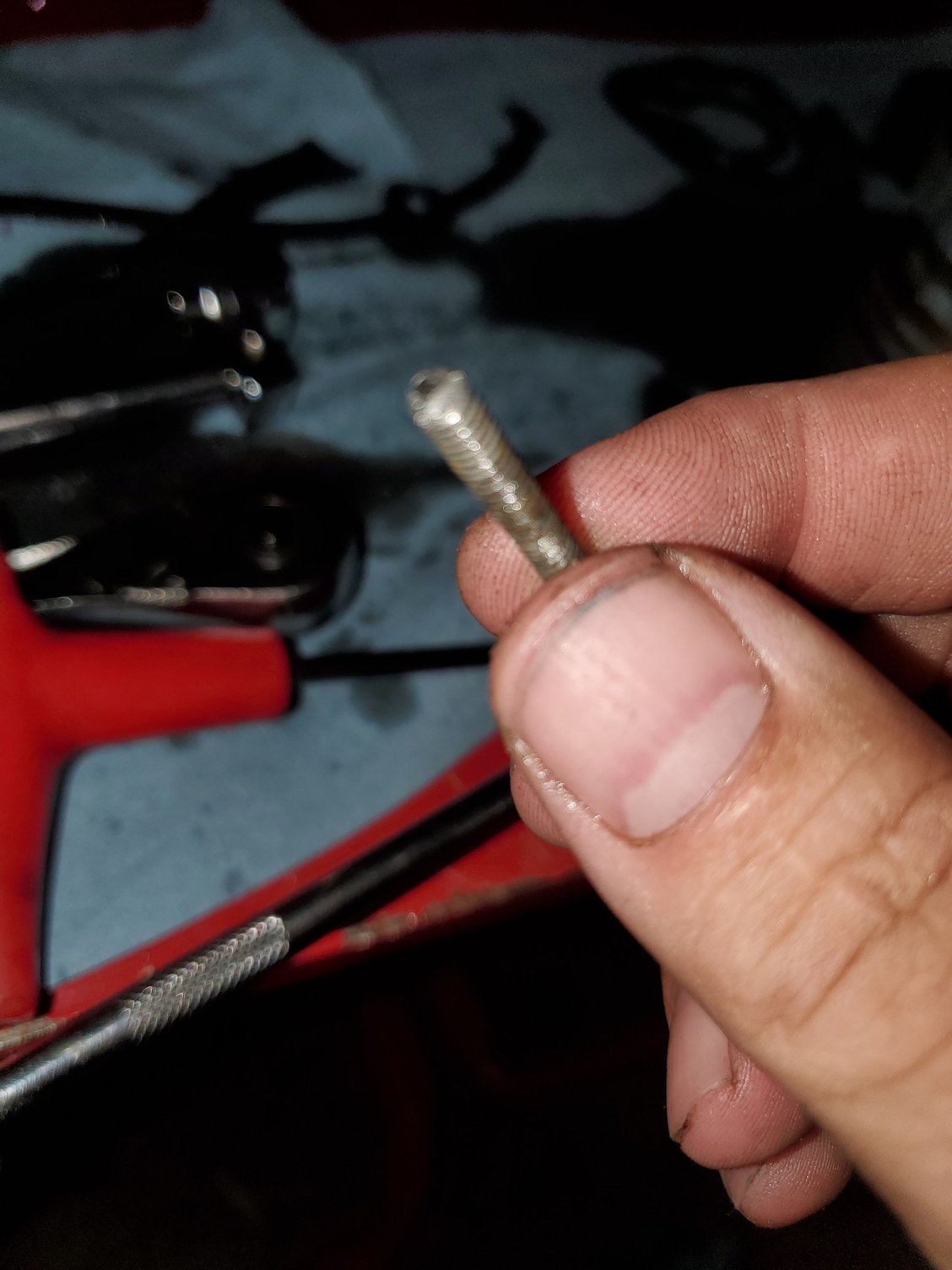

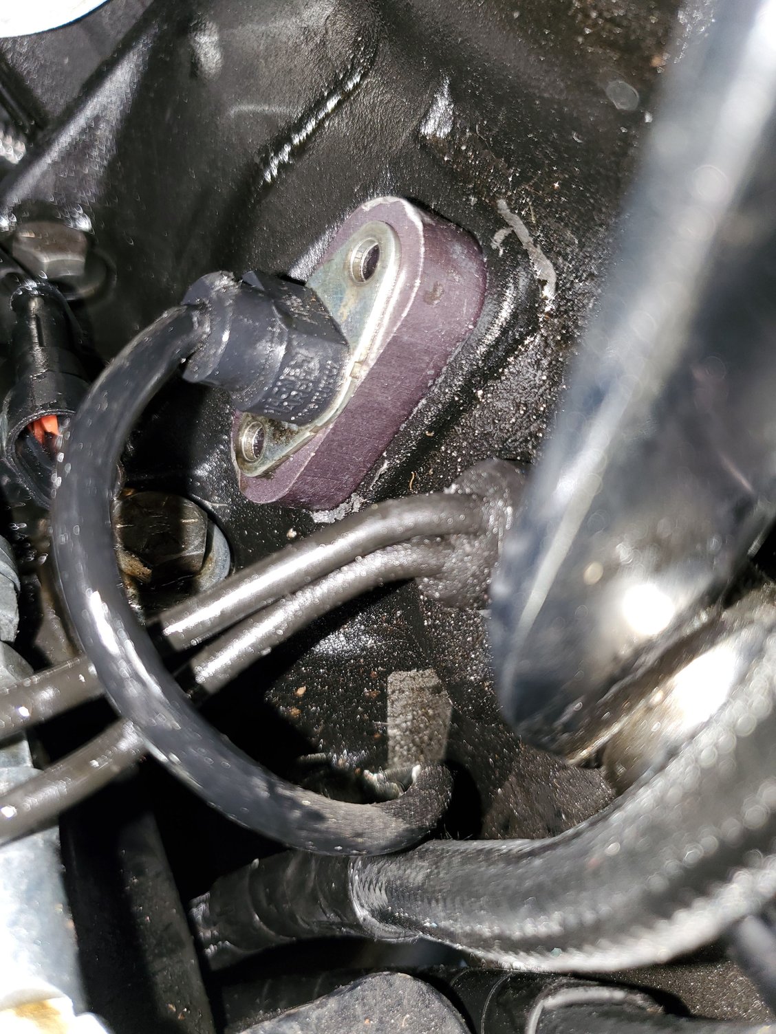

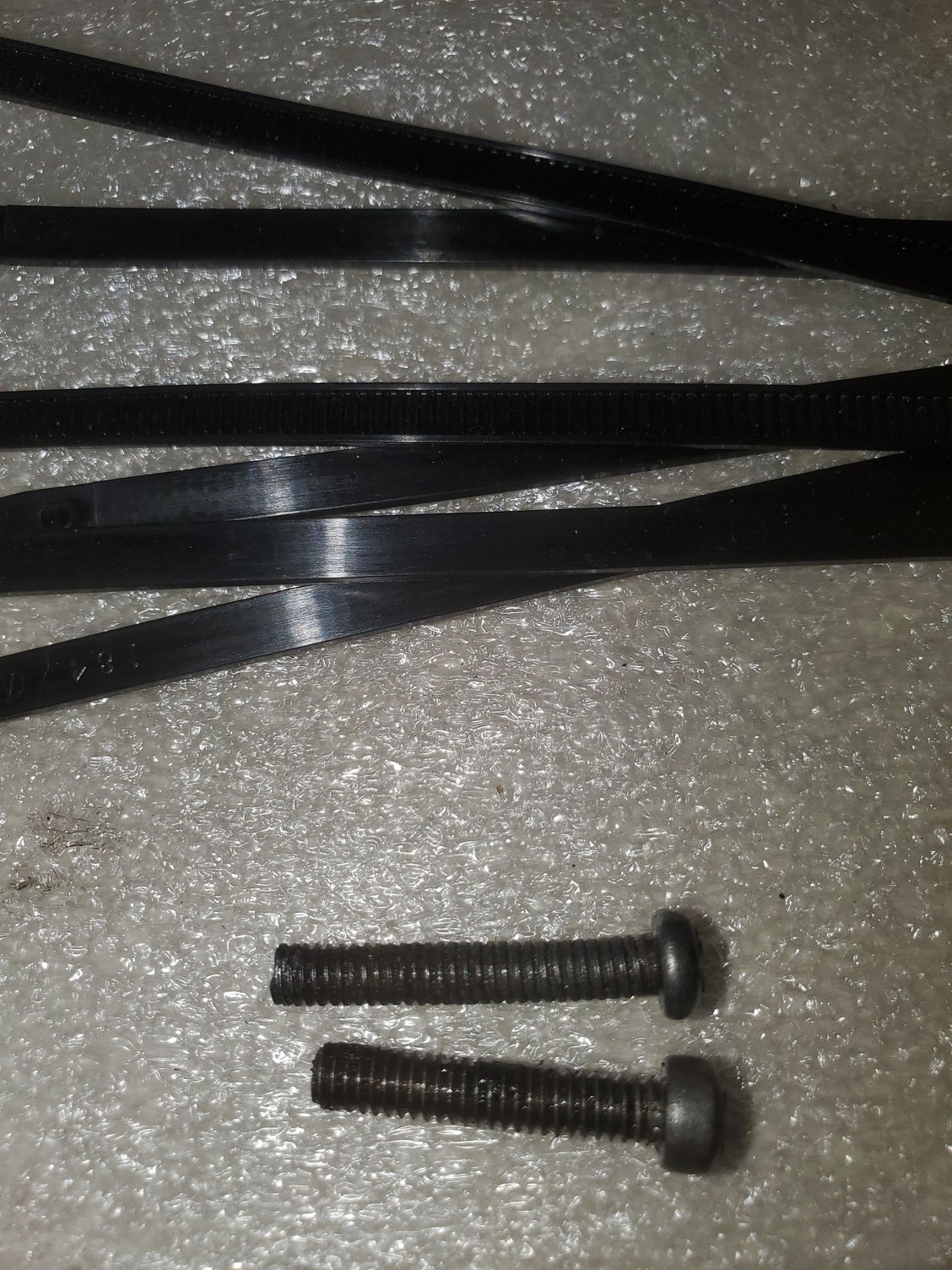

Well I got busy last night and I pinpointed my problem. I'm going to take this walk of shame to possibly help someone else and close this thread.
when I was installing the oil cooler I dropped and couldn't find one of the screws that bolts the sensor to the block. I pulled a screw out of my jar I have of extra stuff. The one I used was just a tiny bit longer. I remember when I put it on it screwed right in. Well it was too long and rubbing. Creating the noise.

Too bad I didn't find the problem till after I pulled the primary putter cover off and I pulled off the block portion of the altracool oil cooler. But I'm happy to know it was a stupid mistake and a easy fix now today i put it all back together and get back on the road.
