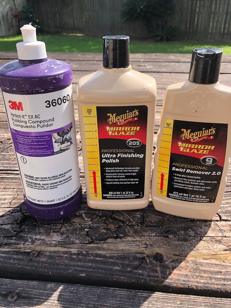

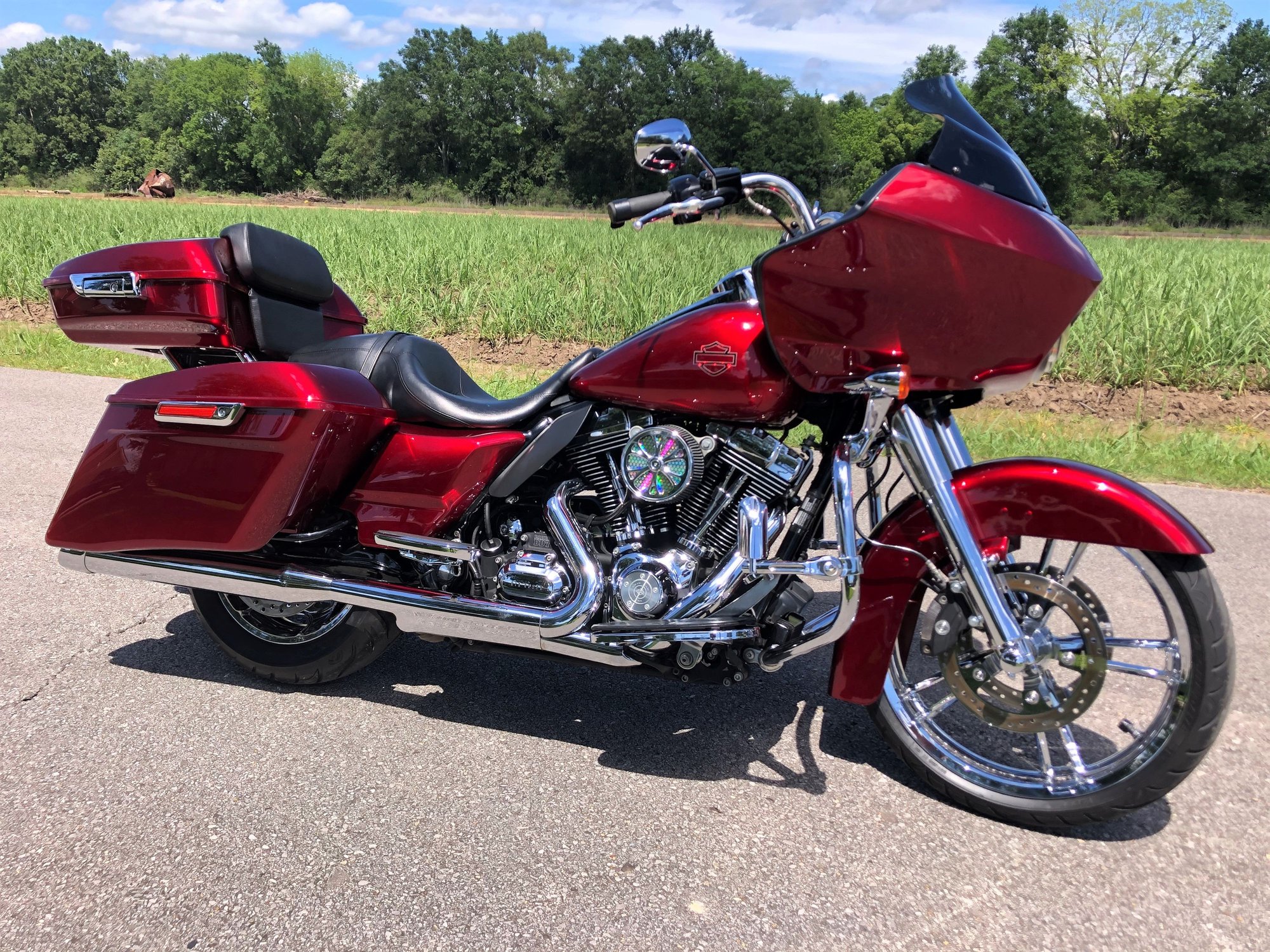

This was what I used and had on hand, the 205 works really well after compound, and the #9 finishes it off nicely, gets rid of the slight halo looking lines, or whatever it's called.
Both Meguiars products said body shop safe, so I assumed it shouldn't seal the surface.
And yes, I was concerned with how long I should let it breath and cure before using coatings.

Beautiful job. WHat's your tank emblem?

Thanks, emblems are CVO style copy

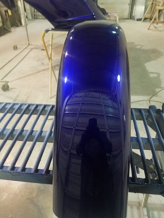

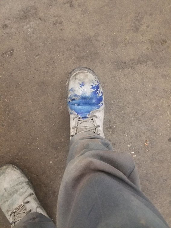

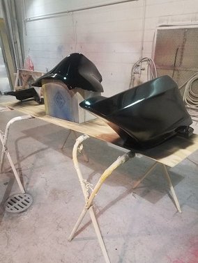

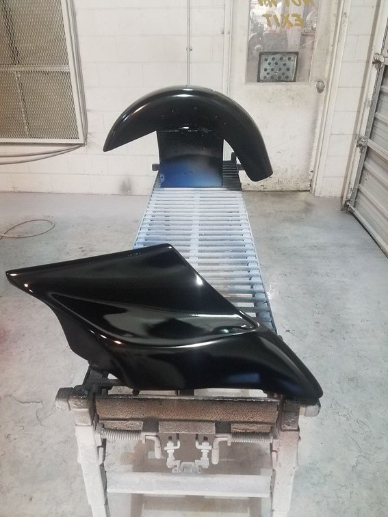

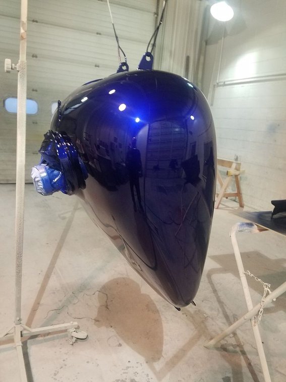

Painted the first wave of parts, several more to go on one of those custom Street Glides. For those wondering the cost of materials, this paint job is at $670 right now at dealership cost. 1 gal of premium reducer is $58, I qt of urethane clear with activator is $118 cost, HOK stuff $$$$$, price of this stuff is out of control. This color does have some purple in it but lights and camera doesn't pick much of it up, really cool color
Used my shoe as a test panel to see what House of Kolor Burple looked like
First color of HOK base black applied
2nd application is HOK blue/purple Candy basecoat called Burple, starting to flatten for the next step
3rd stage is 3 coats of Urethane catalyzed 4-1 ratio thinned for flow

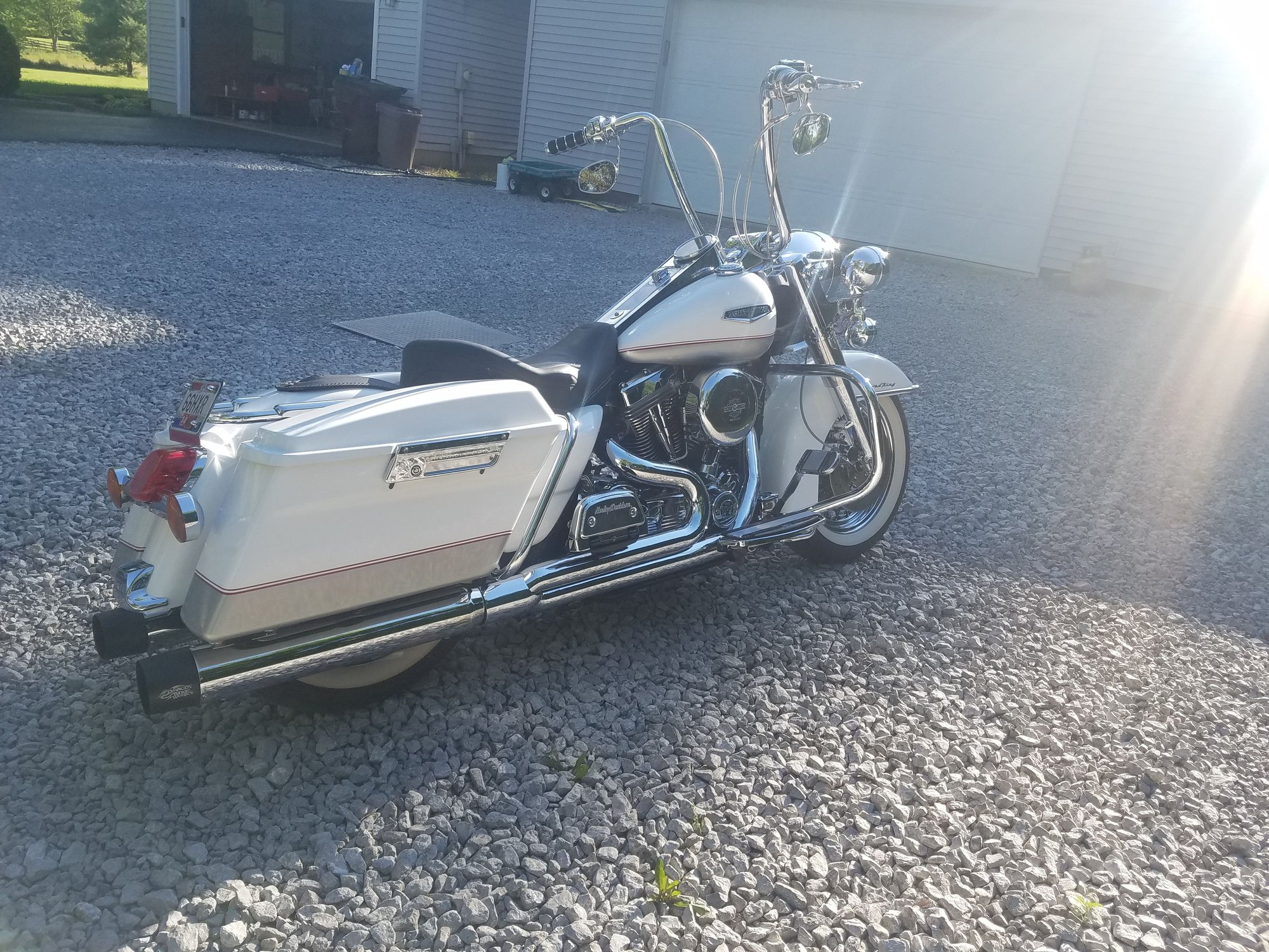

Met up with an old friend today, ran the roads first time since it's crash. Forgot about the soul of a EVO, sure as heck didn't want to get off of it.
Broke down and ordered a C&C solo seat for it being a couple of weeks out, the Mustang Vintage is one comfortable seat but will going back on the Roadglide in favor of the C&C custom seat
