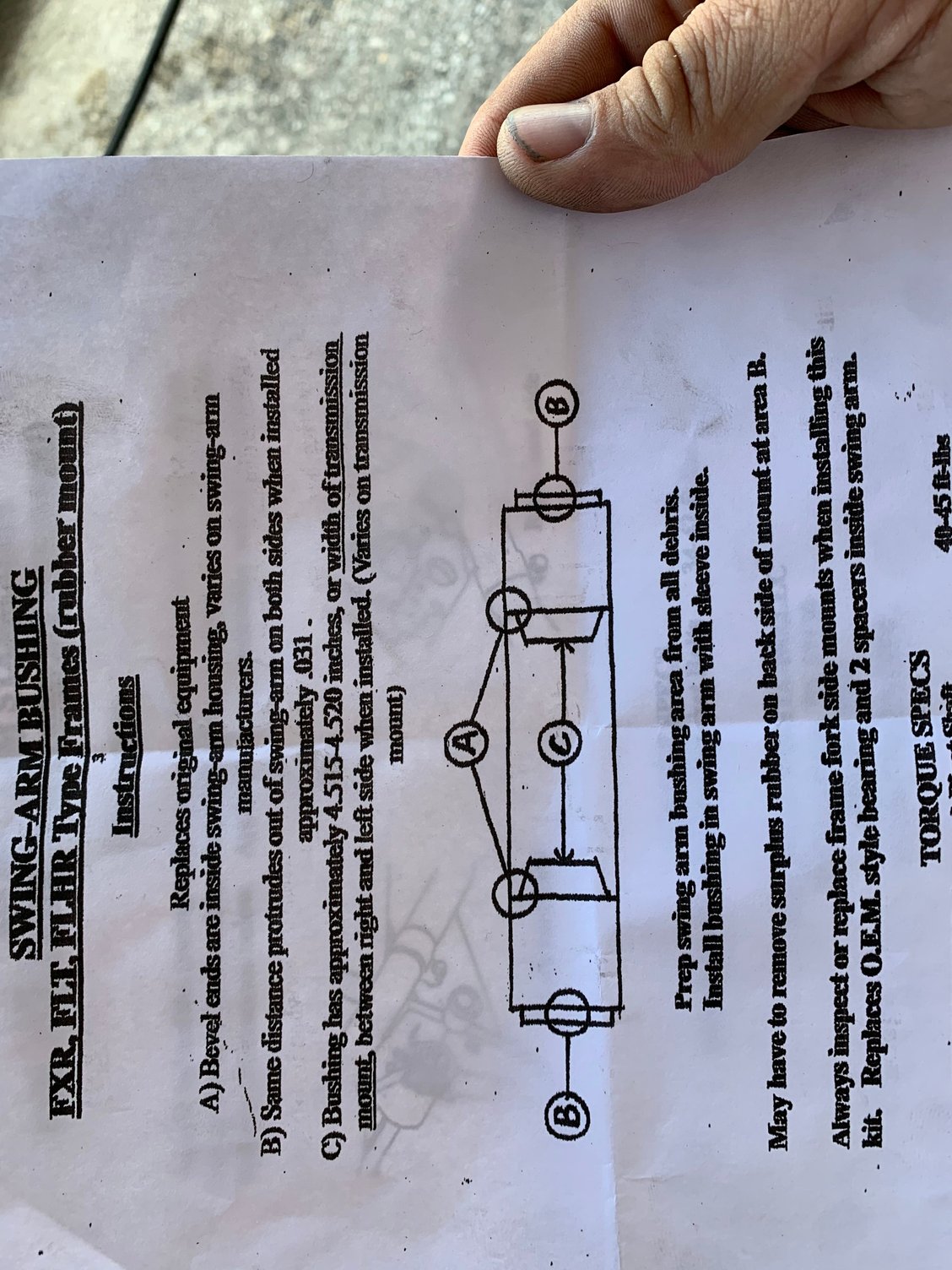

I have my swingarm apart to replace the cleve blocks with a sta bo kit. I seem to be missing two parts. There are supposed to be a pair of spacers in there (47510-80). I don't have them. My dealer says theyre obsolete. Do I need them with the sta bo parts?

The instructions that came with the kit aren't very clear. I put it together the way one drawing sort of looks. Time will tell!

ive been around the block on it. Seems ok. This is the sheet that came with the kit. It looks to me like all the oem stuff gets left out.

Those are pretty basic instructions, to say the least! It would certainly seem that the spacers you mention are not required. I have a True-Track kit in my 1990 Glide and that also has just a single large bushing each side, in a similar style.

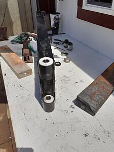

that looks similar to the Vtwin kit that I used for Alma, nothing was needed from the stock system.

thanks. I figured that must be right. nothing else would have fit in there. The bike rides great, too.
