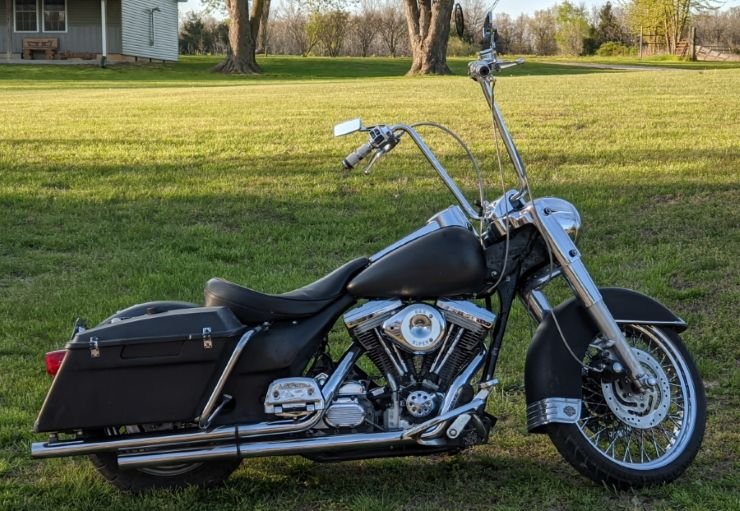

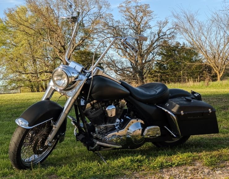

I did that once. I liked it then and still like it.
'90 Electra Glide
Moved on to something else, but still not the oldmanified glide.

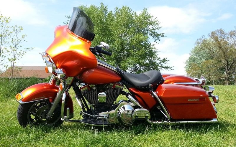

Silver is extremely hard to spray plus a rattle can will be challenging, both those colors are clear coated in your picture. If you want my opinion on the striping it's going to be cheaper to have it done, House of Kolor or One Shot is the go too's on striping paint, the Red on it looks about the same color as I just striped my bike in White Bike thread here but you will need to buy: Red paint, Orange paint, White paint to create the orange color or tint the red, striping brush, 3M striping tape and lay out the lines will be $125 in material. Your not going to find automotive striping tape with 2 different colors or match the orange, not trying to be negative but informative.
Omaha used Spraymax 2k clear coat rattle can on his project and came out good, he learned alot and it's best to clear coat that Silver or the whole part after both colors are applied. You will be applying tape lines to paint the 2 tone anyway meaning your not to far from tape lining the pintripes, just takes patience. I'll walk you thru the striping process if you want to try it yourself, you will have to create the orange color my mixing paint and can be done. The guys you see doing it freehand are aliens, most stripes are run with striping tape and paint applied with a sword brush, designs are freehand.
