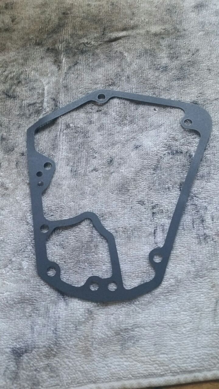

Originally Posted by jamienj
......... I was pissing oil out of the bottom also, ...........
That incorrect gasket can (and will) cause a lot of that, not to mention if your cam cover is for a post '92.

Correct gasket looks like this

Yes, cam covers, cases are also different 92 and earlier bottom breathers. A picture of the cam cover inside will tell if you have the correct one.
