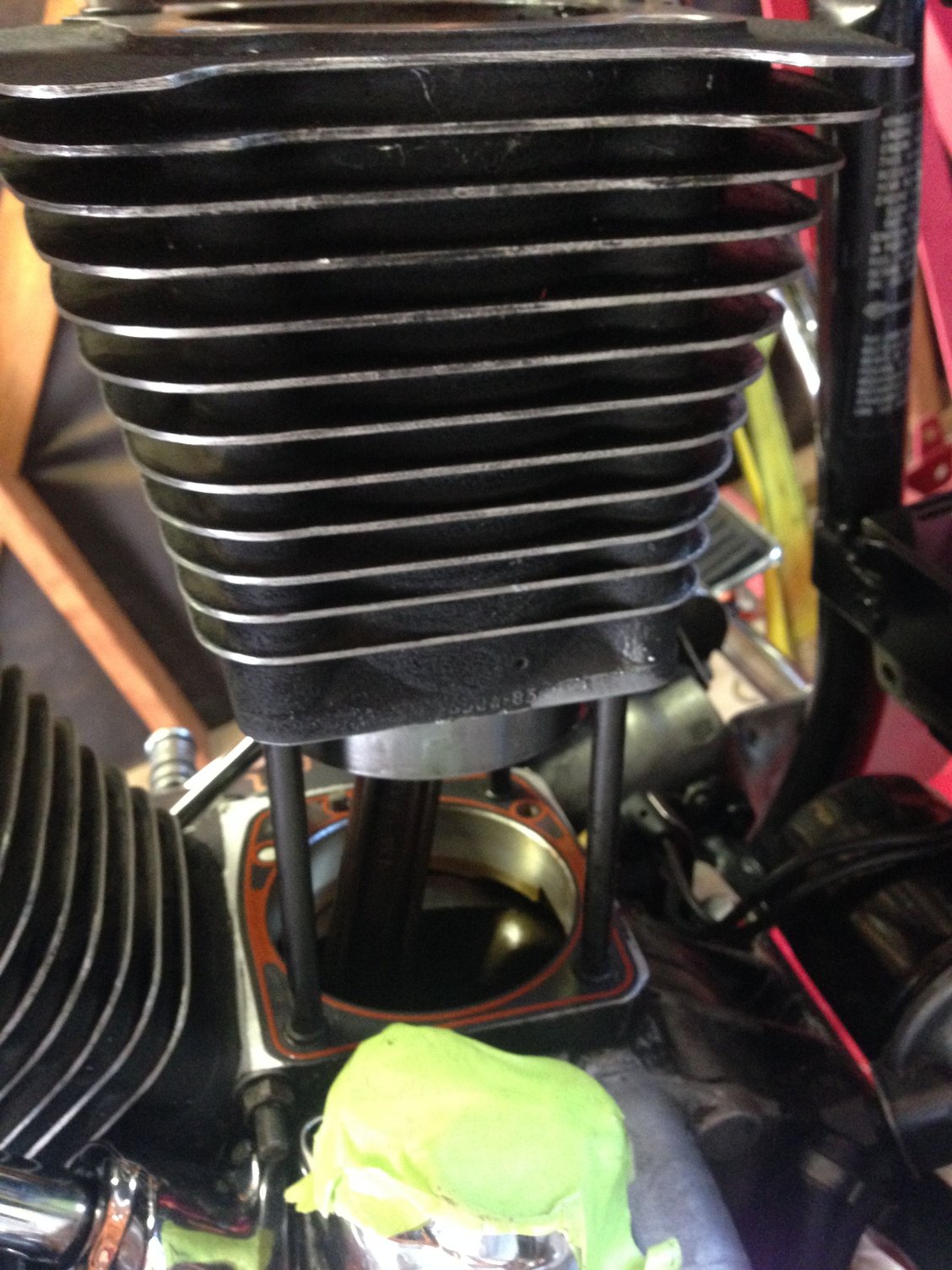

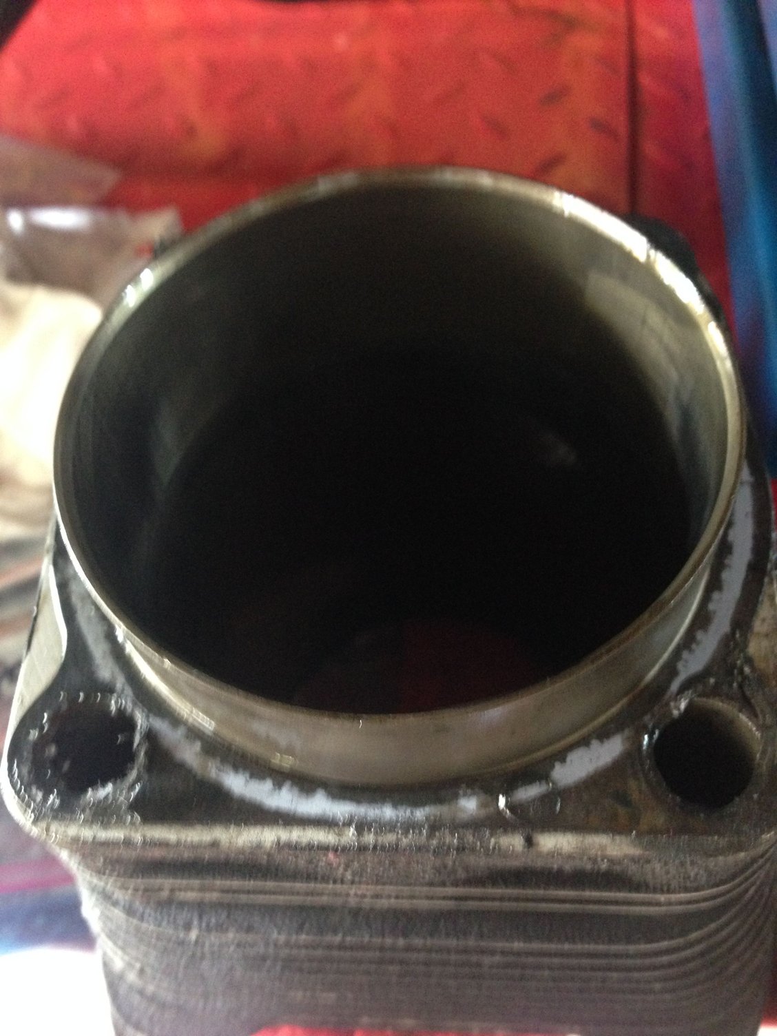

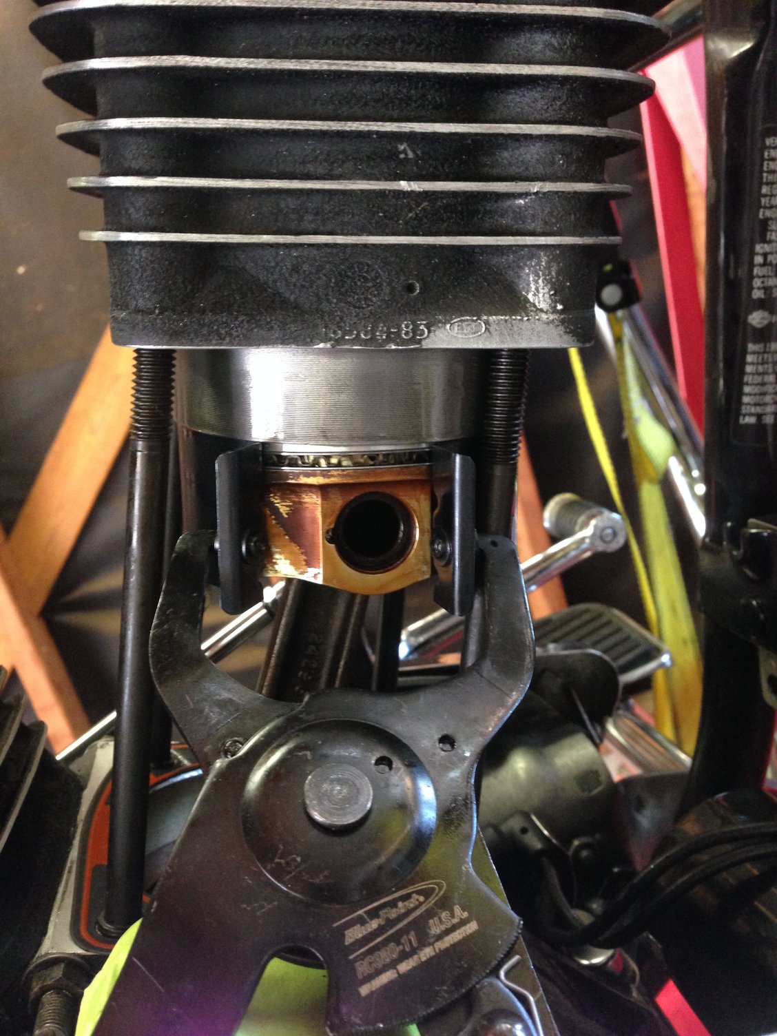

I installed the new James base gasket. The piston ring compressor tool worked great. The job was easier than I expected. Hopefully I can fire up the bike this weekend.
