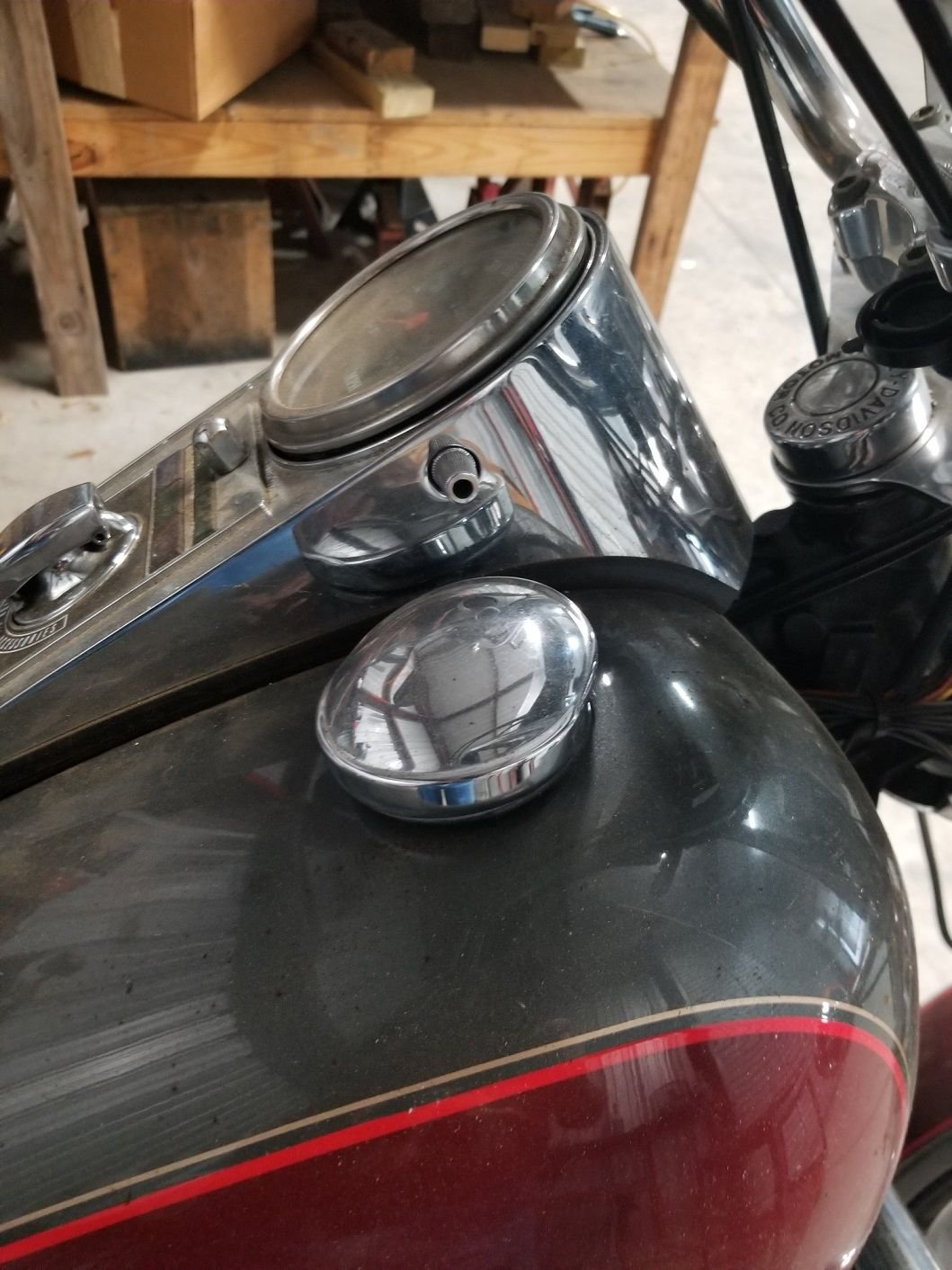

Not yet but if you want me to I can.
It might be a bit though as I just finished supper and don't really feel like moving!!!!!

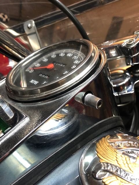

Hows does the speedometer sit in the instrument panel? It looks like the previous owner replaced the glass and the trim ring on the speedometer. It takes a little twisting and pulling to get the the instrument cluster off the speedometer. Question does the spreedometer sit below the instrument panel utilizing the flange on the speedometer or does the speedometer push through the instrument housing with a gasket between the speedometer and instrument panel. Currently the speedometer sits about a 1/4" about the instrument panel. Could the previous owner put the wrong bezel on it? Also I can't push the speedometer down any farther to make it flush? The exploded view doesn't provide any help or nor does the service manual? Any help would be appreciated.
that pic is what both my 94s look like

It looks like the bezel, and glass covering the speedometer is not flush to the dial.

Here you go

iirc, the speedo is mounted to the console bracket, and the console is mounted separately. They are not bolted together. You need to lower the speedo mounting points on the bracket.

If he does that then his trip meter reset **** won't fit through his dash anymore.

The mounts are bottomed out.
