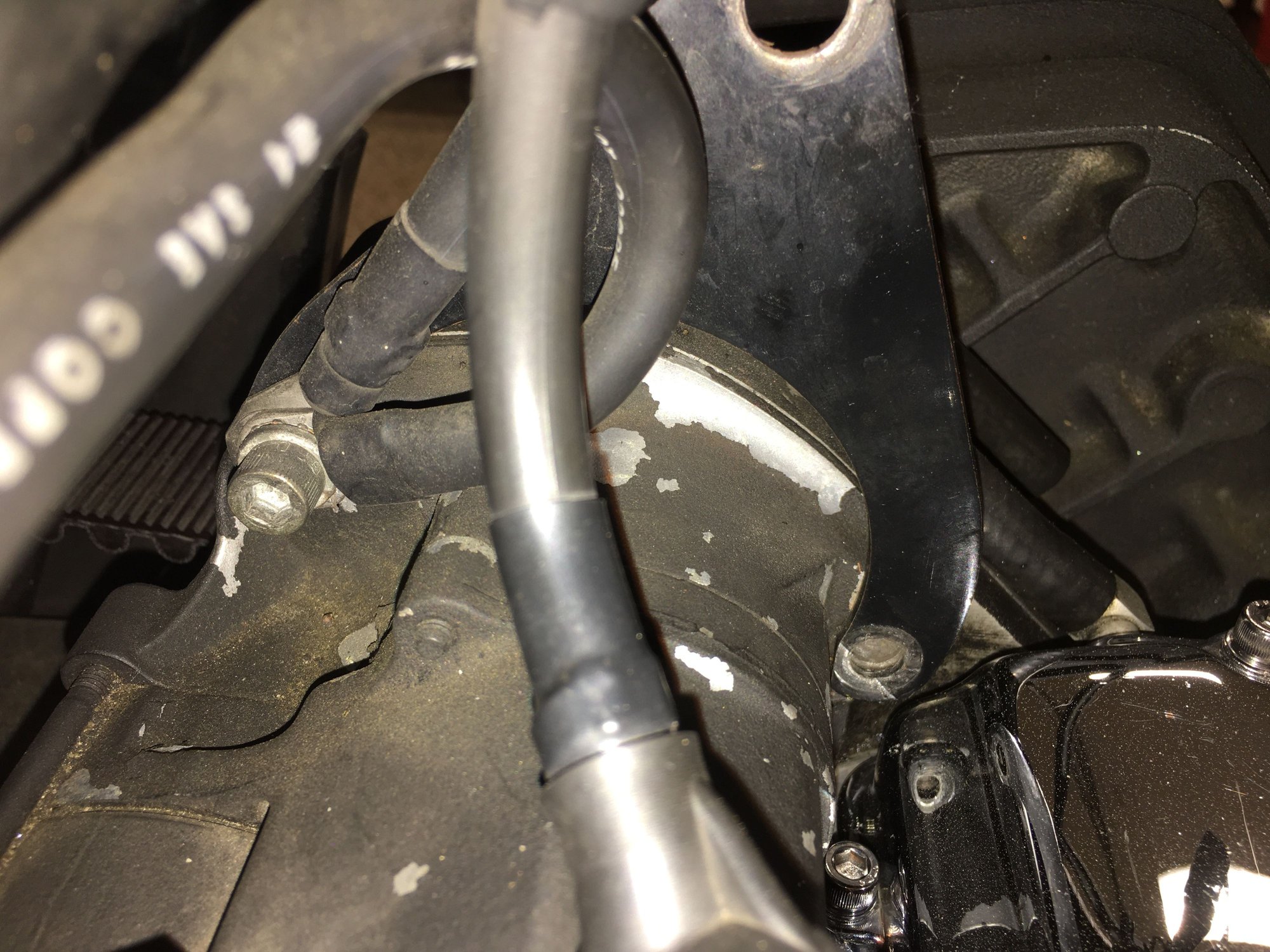

Here's a picture of my '93 FLHTCU. I removed the forward bolt so you can see the bracket.
Well that really has spoiled all our fun! Now we'll never know if Daven got it right first time....
