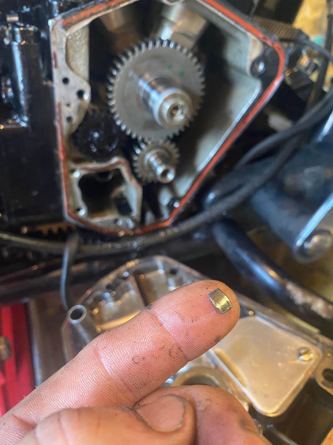

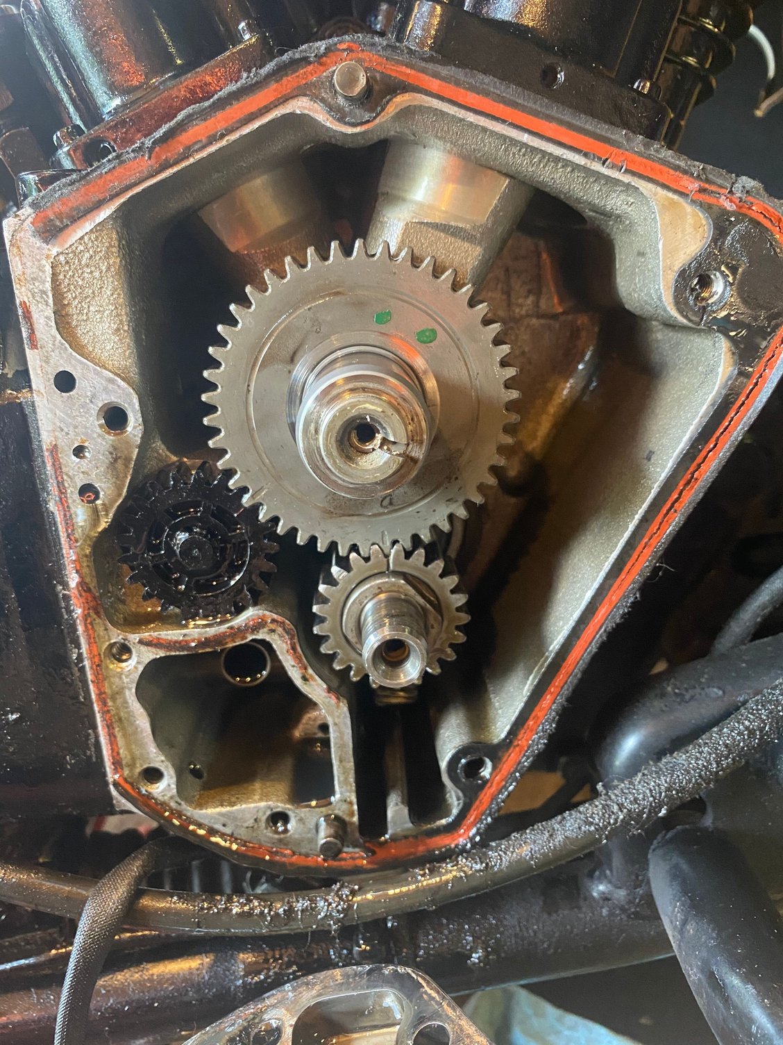

Removed the cam cover and didn’t see anything obviously wrong. I did find a metal piece on the bottom of the chest but that was it. I’m guessing the issue is inside the oil pump?

looks like a piece of the oil pump woodruff key. Your going to have to dig in more to the pump and pump shaft (where the key goes).

Best guess - and it may not be, but looks like a piece out if the cam bearing. Different angle of pic would help but looks too flat and big for oil pump gear key. It was in the gear side of the cam chest, right?
Don't shoot the messenger but best keep digging... and pull the pump also.

The metal pieces was laying right under the cam on the bottoms of the case. I will pull the oil pump next. I rotated the engine using the back tire and everything rotated like it should. Thanks for the help guy!

I figured it was, but forgot to ask. Pulling the pump won't be a waste of your time. If it has adjustable push rods, not a problem to pull the cam, but regardless, better do that too before you get done. (and makes it easier to manipulate the oil pump drive gear on reassembly).
