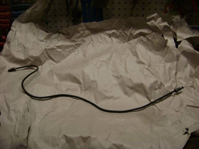

Don R's Avatar
Don R
Joined: Jun 2020
Posts: 35
Likes: 17
From: Wilkes-Barre PA
this is what found for my rear brake flex line, gotta love the PO of this bike.
If you can't get it hard line it
