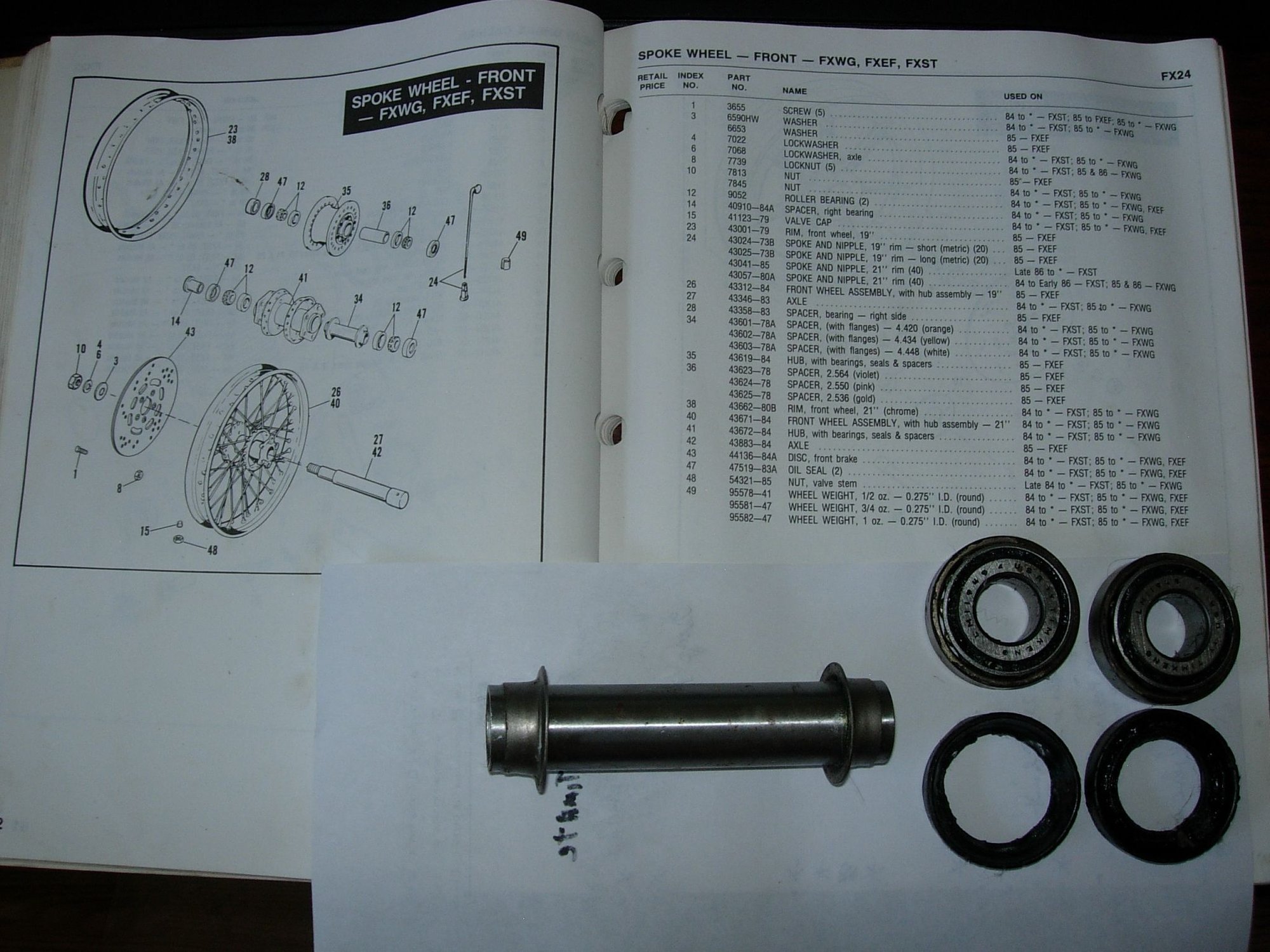

Thanks for the link. Here is the dealer invoice (sorry, I spilled water on it) I have hub #41 in the parts catalog.
So it looks like they removed spacer 34 (part # 43601-78a) which has flanges on either side and replaced it with part # 43608-82 which doesn't have the flanges. They then added 5 spacer-type washers. I gave them new bearings and oil seals which is why they're not listed on the invoice. The wheel has not been apart yet to confirm the order in which they installed the new parts, so I'm unsure of that. I also don't know if the part numbered 14 (in the parts catalog) was kept on there either. But it wasn't returned to me. So what are your thoughts? Also, if someone can tell me if the wheel is correct to be offset by 1/8 inch I'd appreciate it. Thanks for any help you can provide

As for your offset wheel that's normal but varies bike to bike.
The only thing that's important is if your bike tracks straight when you let go of the handle bars.
With or without a flange you need part 14 to space the wheel off the fork leg.
The top 2 are just shims and order doesn't matter.

Will put the original oem setup back on the front wheel. Highly doubtful the wheel should be offset like that.
