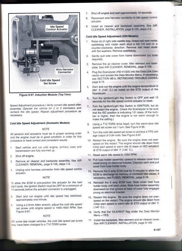

Will this help?

Check to see if you have a stored fault code. If the engine temp sensor is bad, the code will be 14. The procedure to get the code is in the service manual or you can also search for it here in this forum.

@Beemervet thank you for the copy, took all steps as shown by the repair/service manual.
