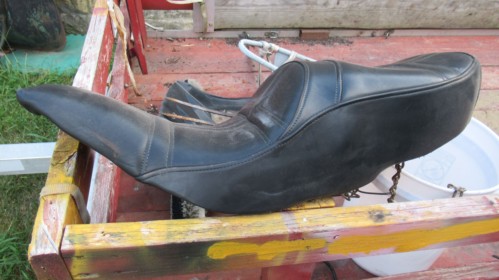

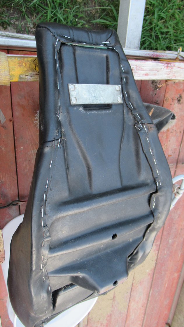

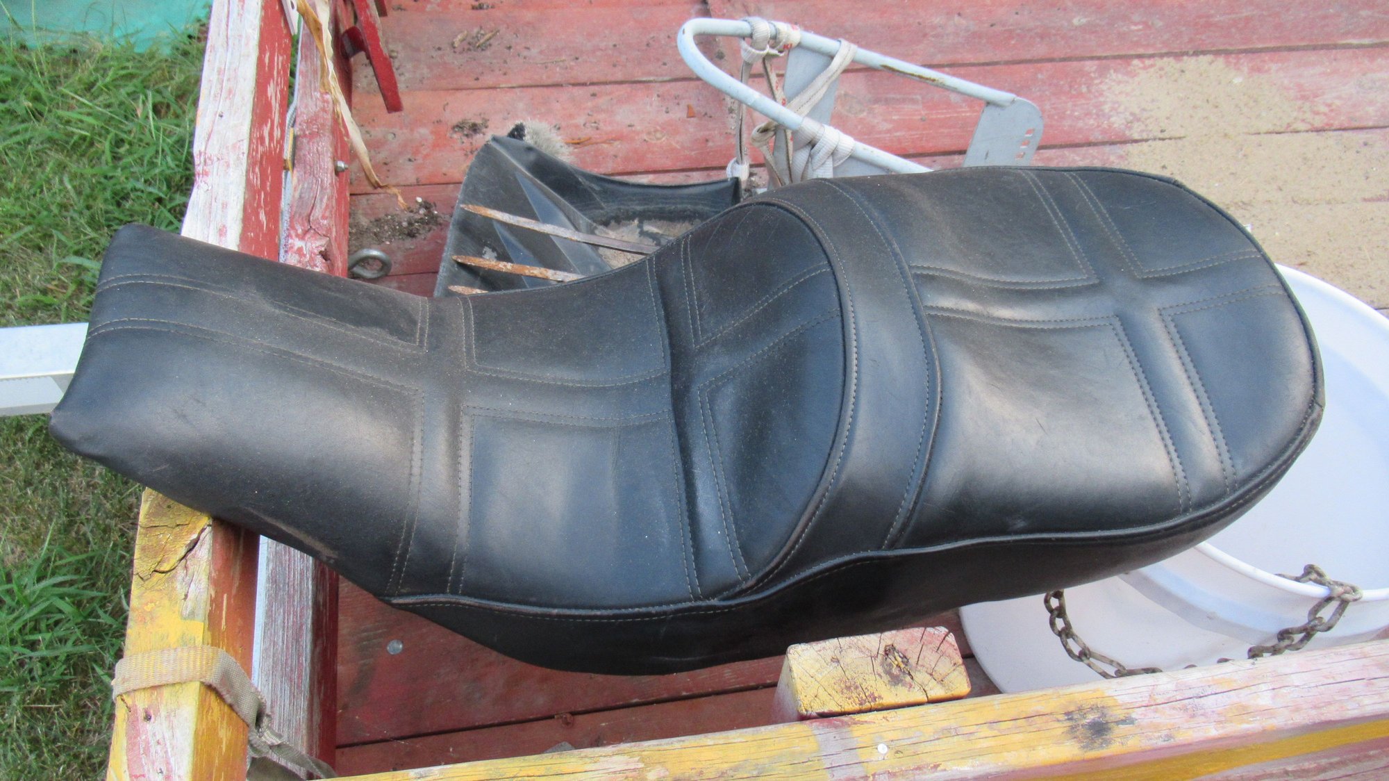

here's the stock original seat from my 85. it was redone in leather. the stitching on the seat is an exact replica of the pattern that was on the vinyl. it bolts to the sides of the passenger handrail bracket, the bolts are 5/16 fine thread.

Looks like same bottom plate as my '87 except my rear bolts are 1/4-20. I may get one of 2 seats re-done instead of looking for another, assuming I can find someone to do nearly as nice work as you did.
Thanks much for the photos bagga!
