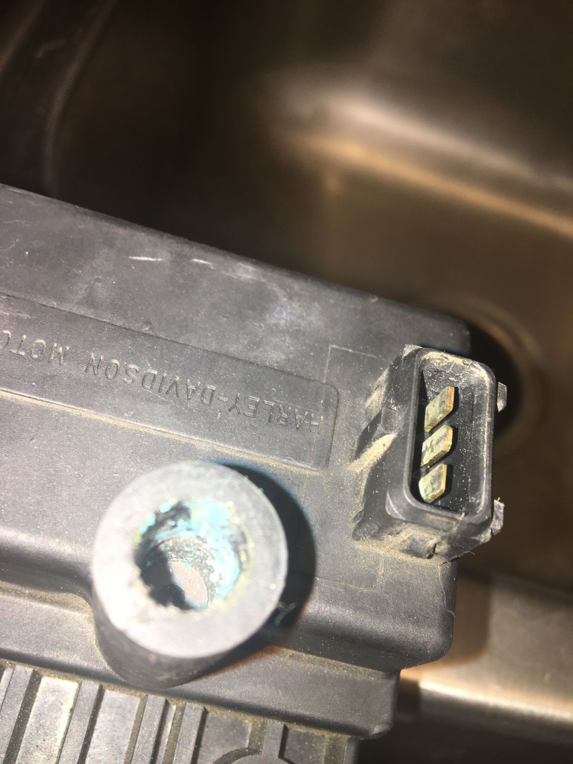

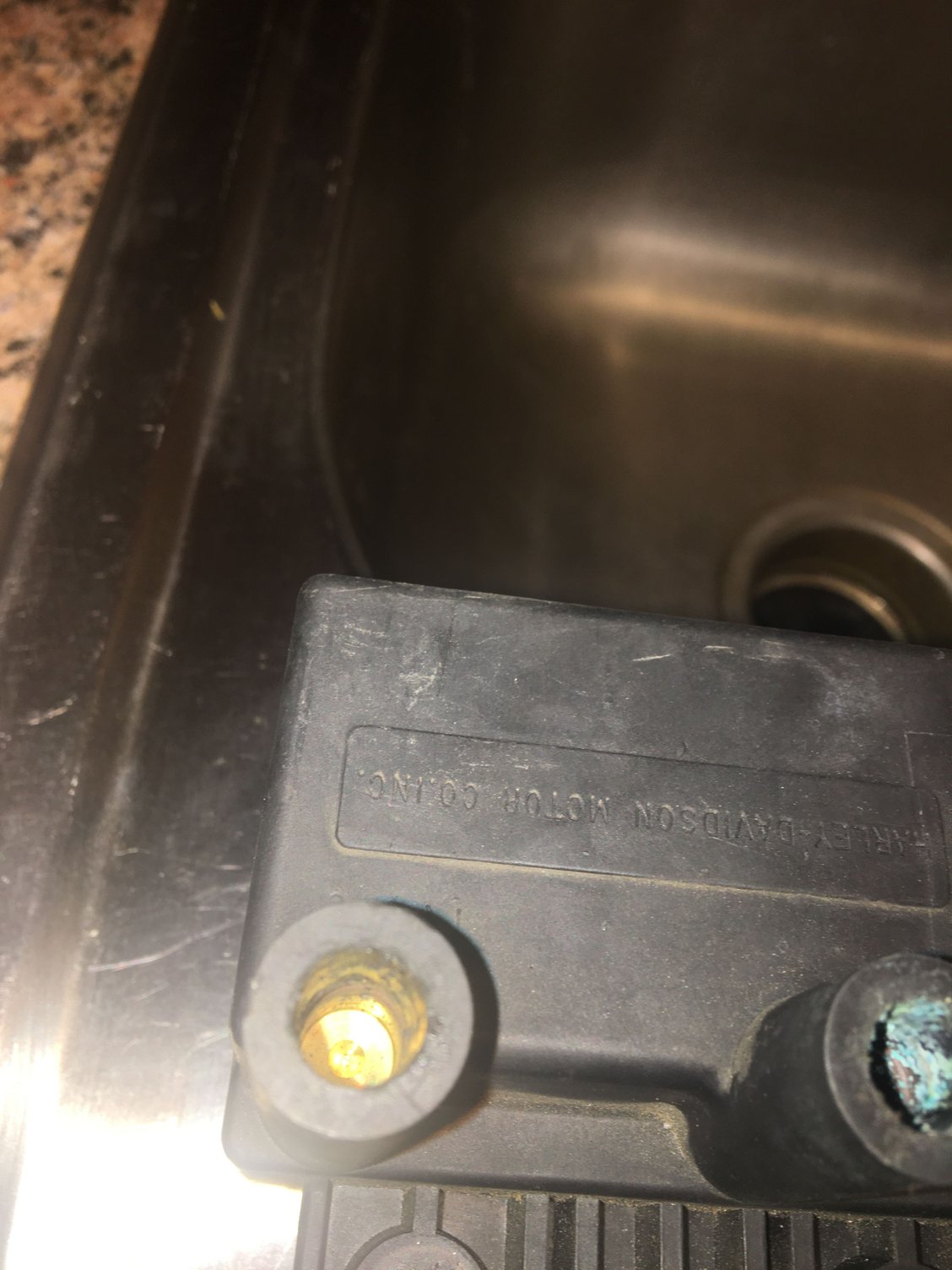

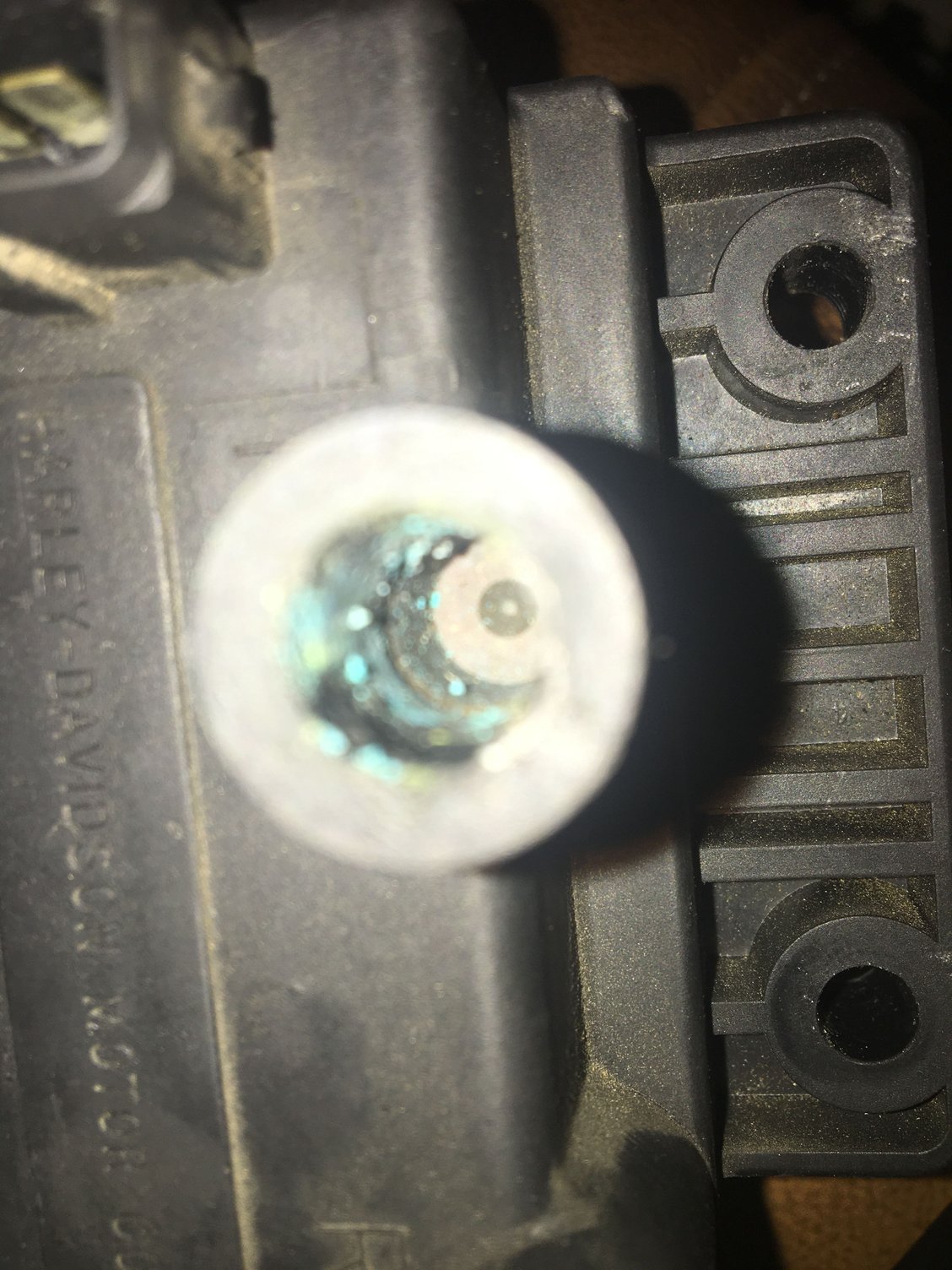

For us with the crazy MM EFI.....
My bike has been running great with no check engine light. It would sometimes cutout under a light load and sometimes ping while traveling down the highway.
New spark plugs and wires.....didn’t help.
Cleaned throttle body.....didn’t help.
I actually removed the coil from under the tank....here’s what it looked like....
Anyways.....something to consider if it’s cutting out under a light load. Replaced it put dielectric grease in them and no more issues.
It was the original coil from 1998. Just passing this along.
