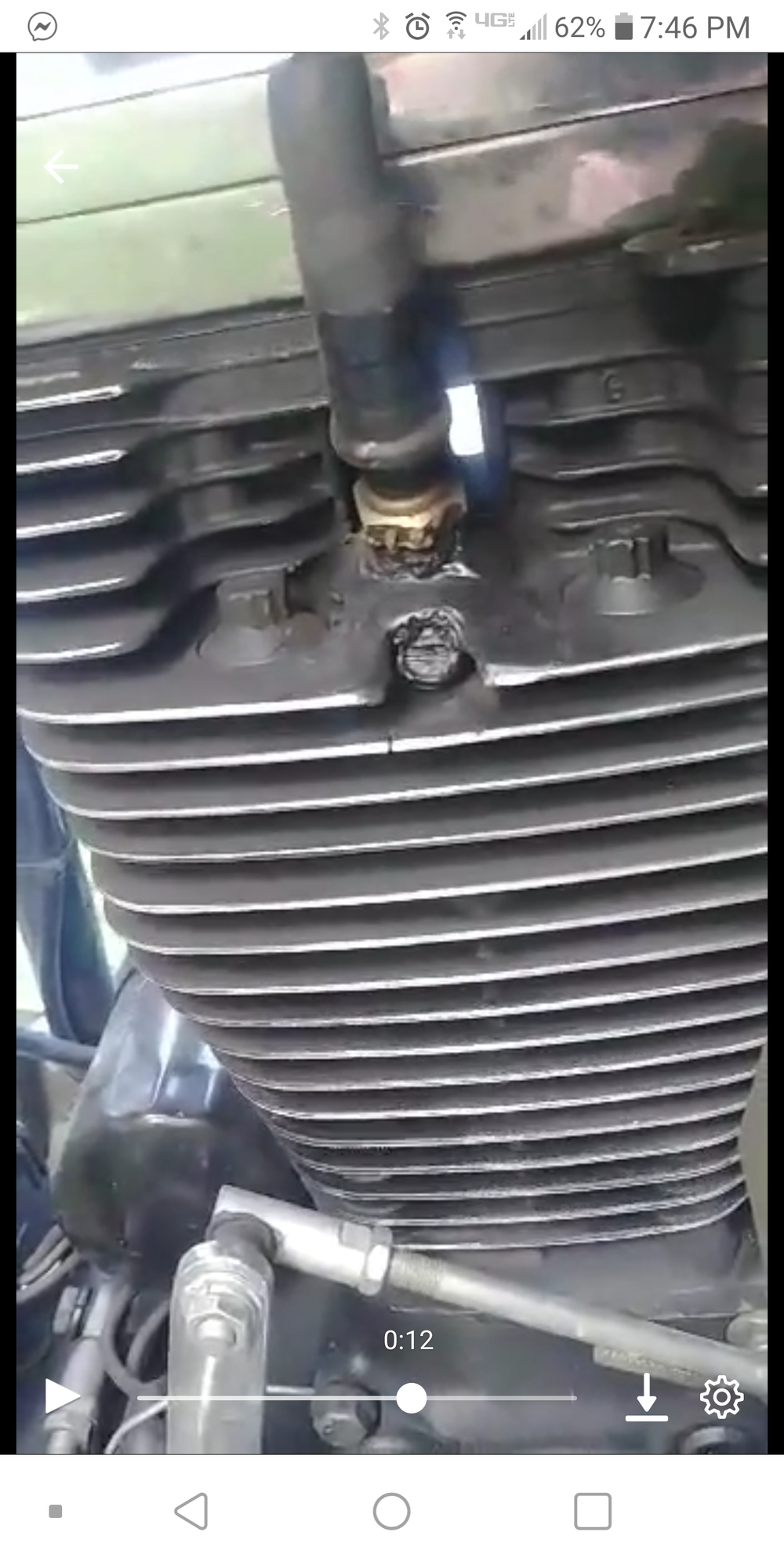

No idea what is going on in this picture but I know enough to see it isn't correct.

Looks to me like someone over tightened the spark plug and blew out the head. Not sure what the hose clamp is really doing

Wow thats jacked up!! is that JB weld holding the spark plug in?

Pretty sure it is lol. Strange part is the bike runs fine. Little lifter noise

lol well its a good cob job if it runs, check your bolts that hold your backing plate for your air breather that go into the heads, if bolts are hollow top breather
