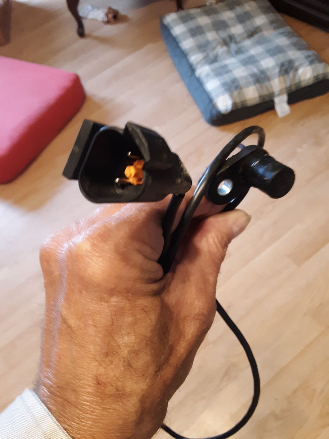

This is something to put in your notes for future use. Some times the speed senors just do not give correct speed. Even cleaning the sensor or replacing it does not work. This unit while not part of you current issue will work on your bike and allow you to adjust the speed to read correctly.
https://www.dakotadigital.com/index....od/prd1011.htm
If you need yo trace speed sensor wire all the way back up it will require splitting the tank. Not as hard as it looks . At first just loosen front mounts bot sides and remove rear mount bolts under the seat slight spread the tank half's you will see the triangle shaped connector.
If you find no wire issue you may need to go farther.
This is the speed sensor cable removed from the bike. it is not hard to fish a new one in if needed of to trace it down for wear. It is long.
Owning a 20 plus year old EVO is still a great ride. It will often require a bit more home work.
