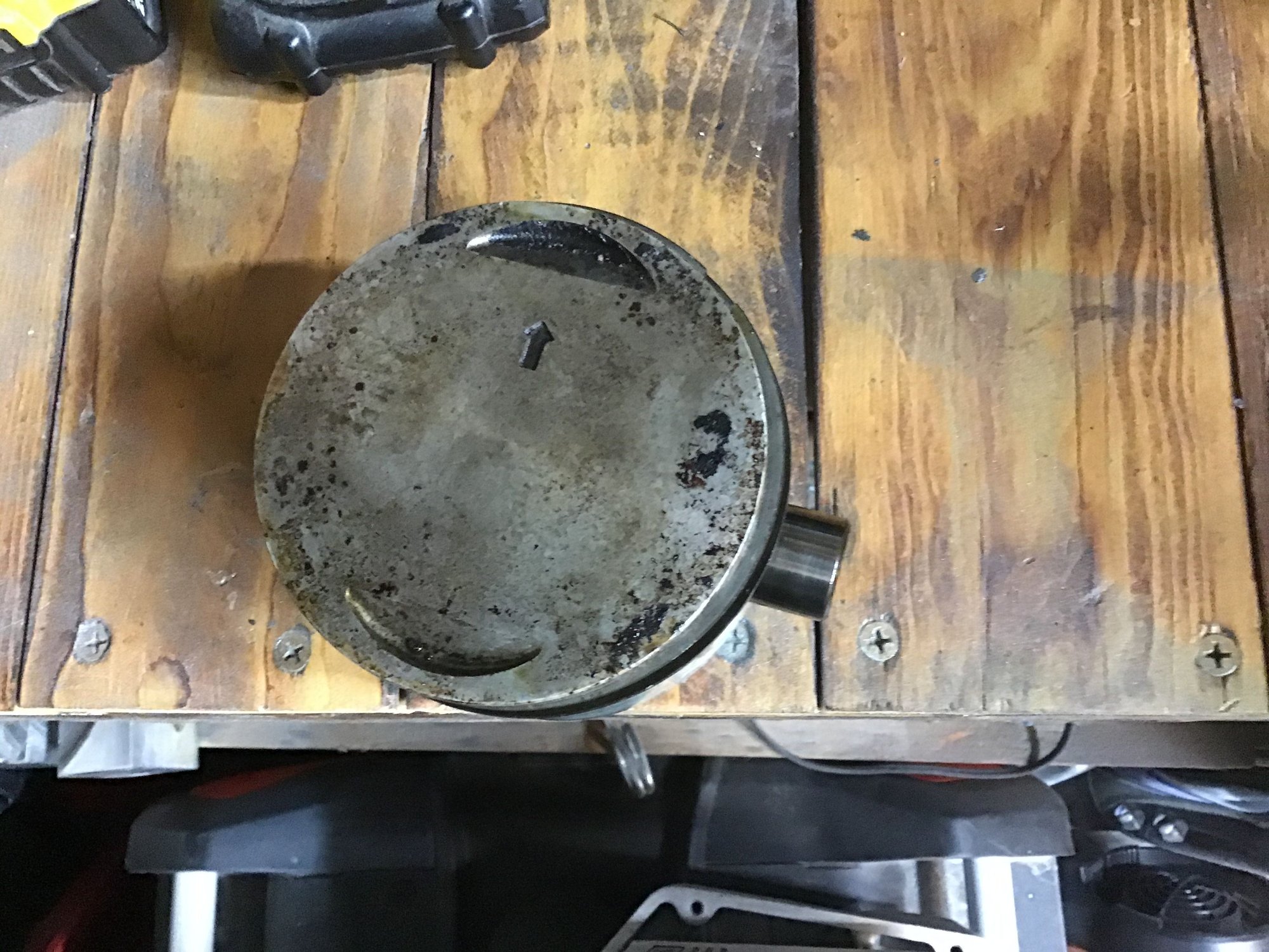

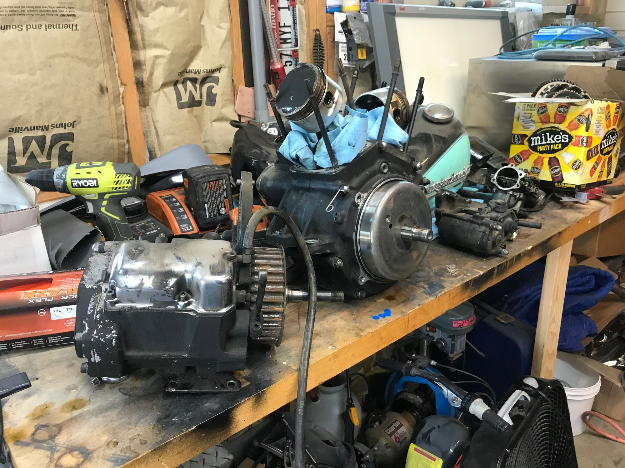

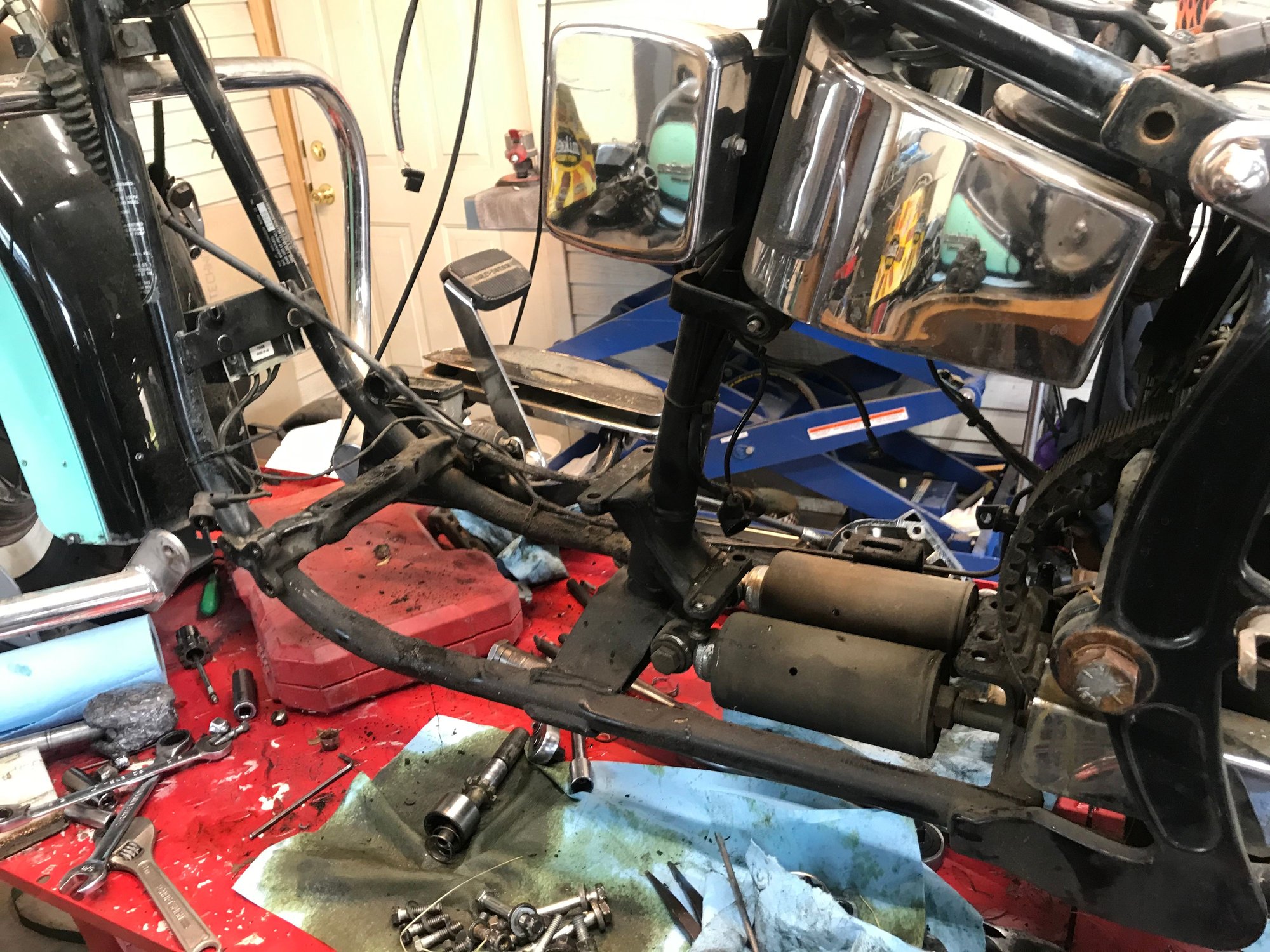

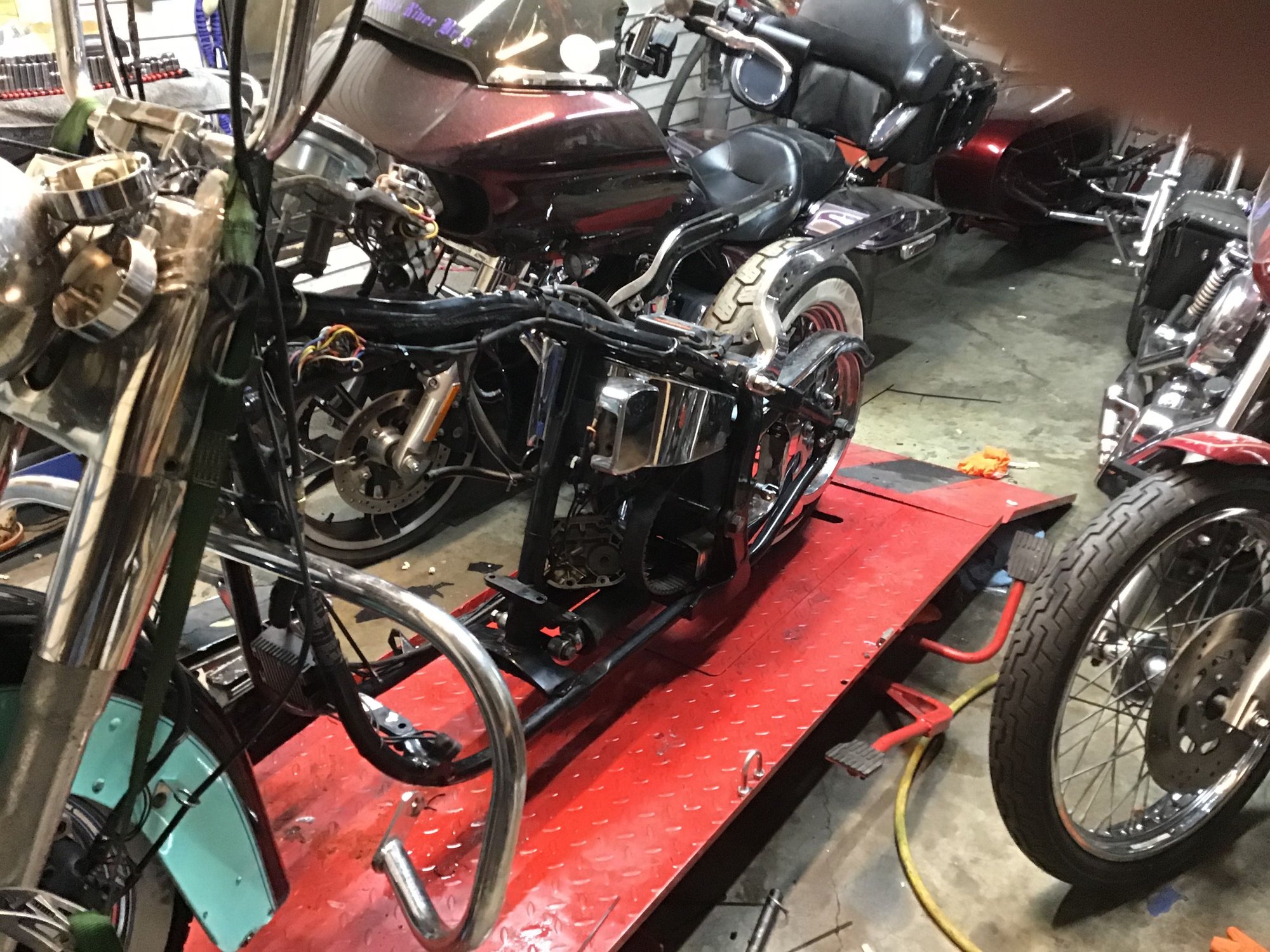

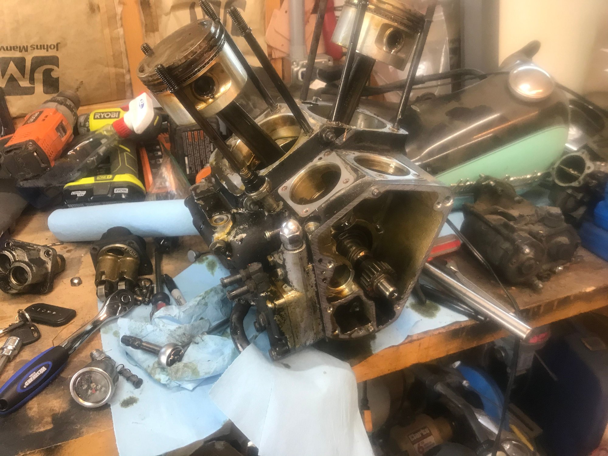

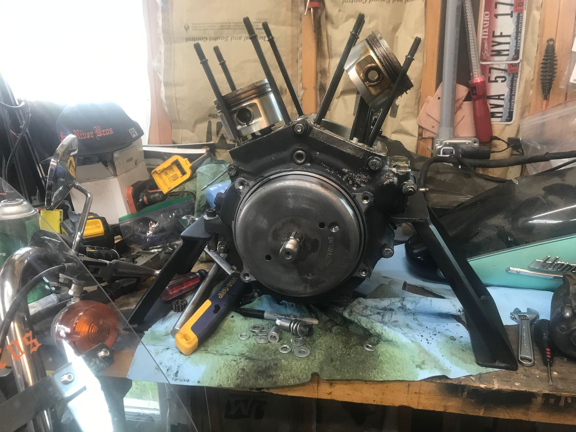

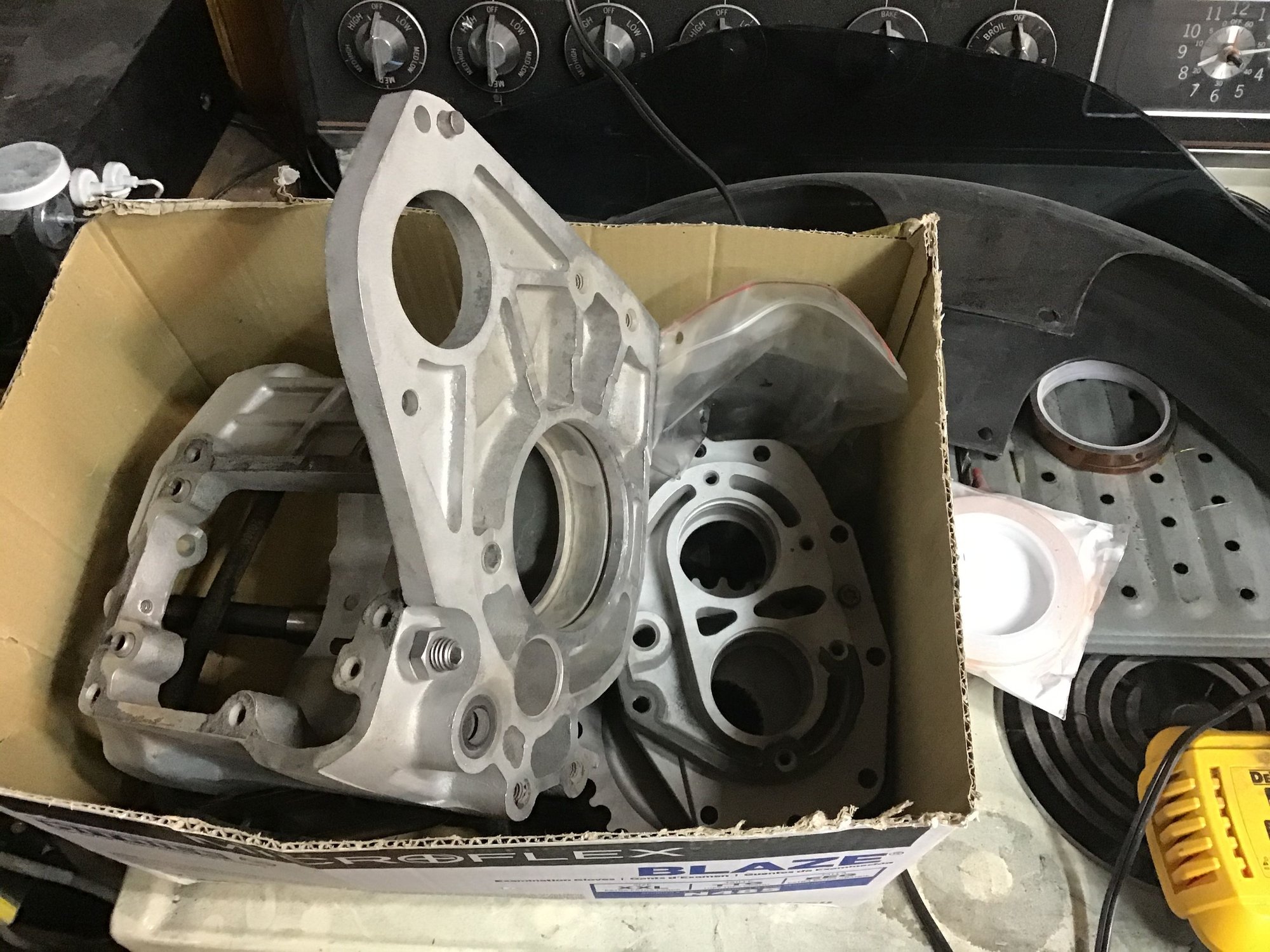

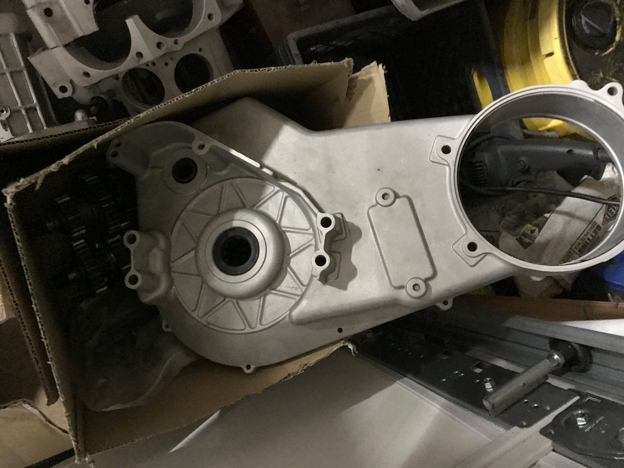

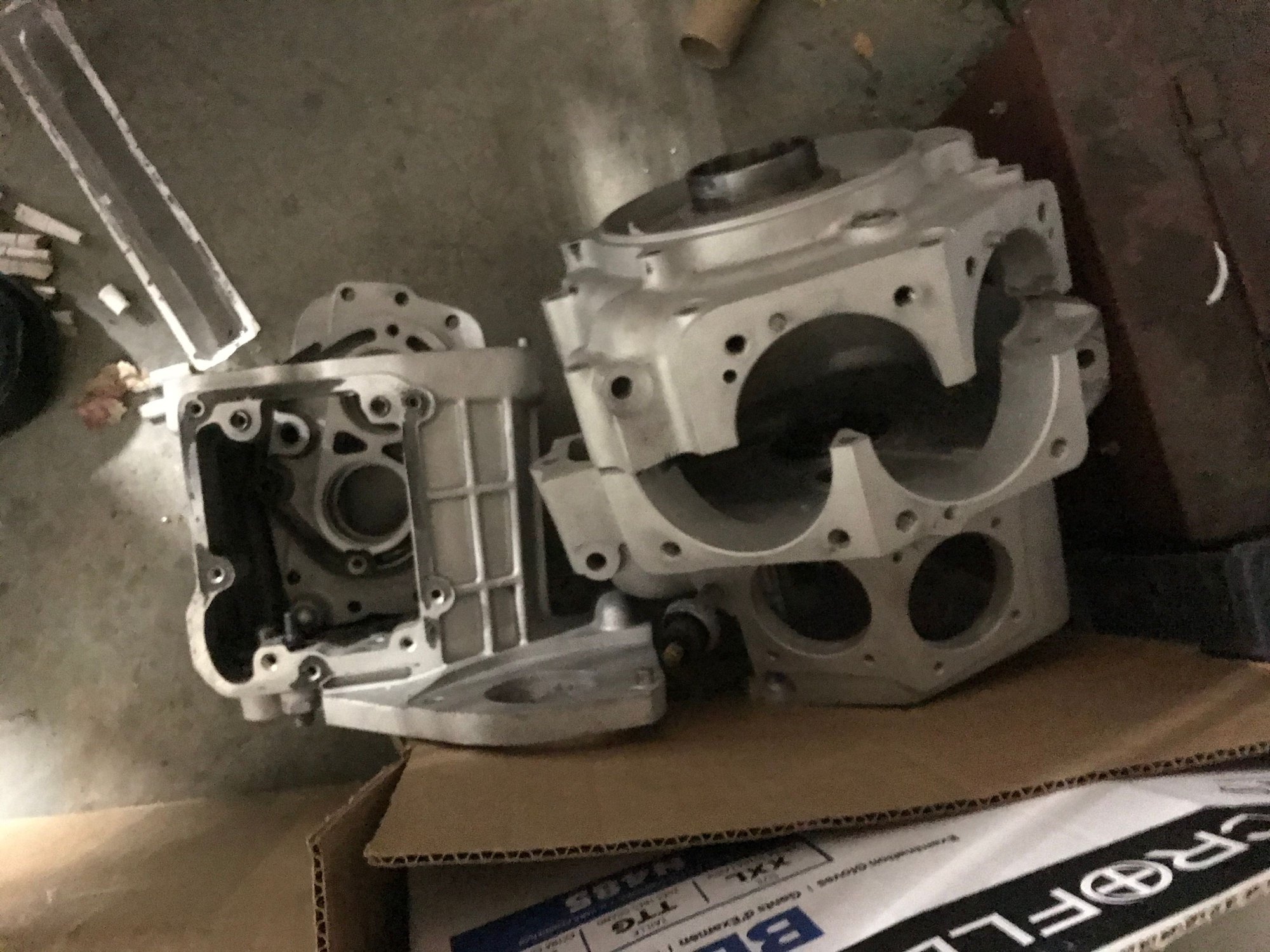

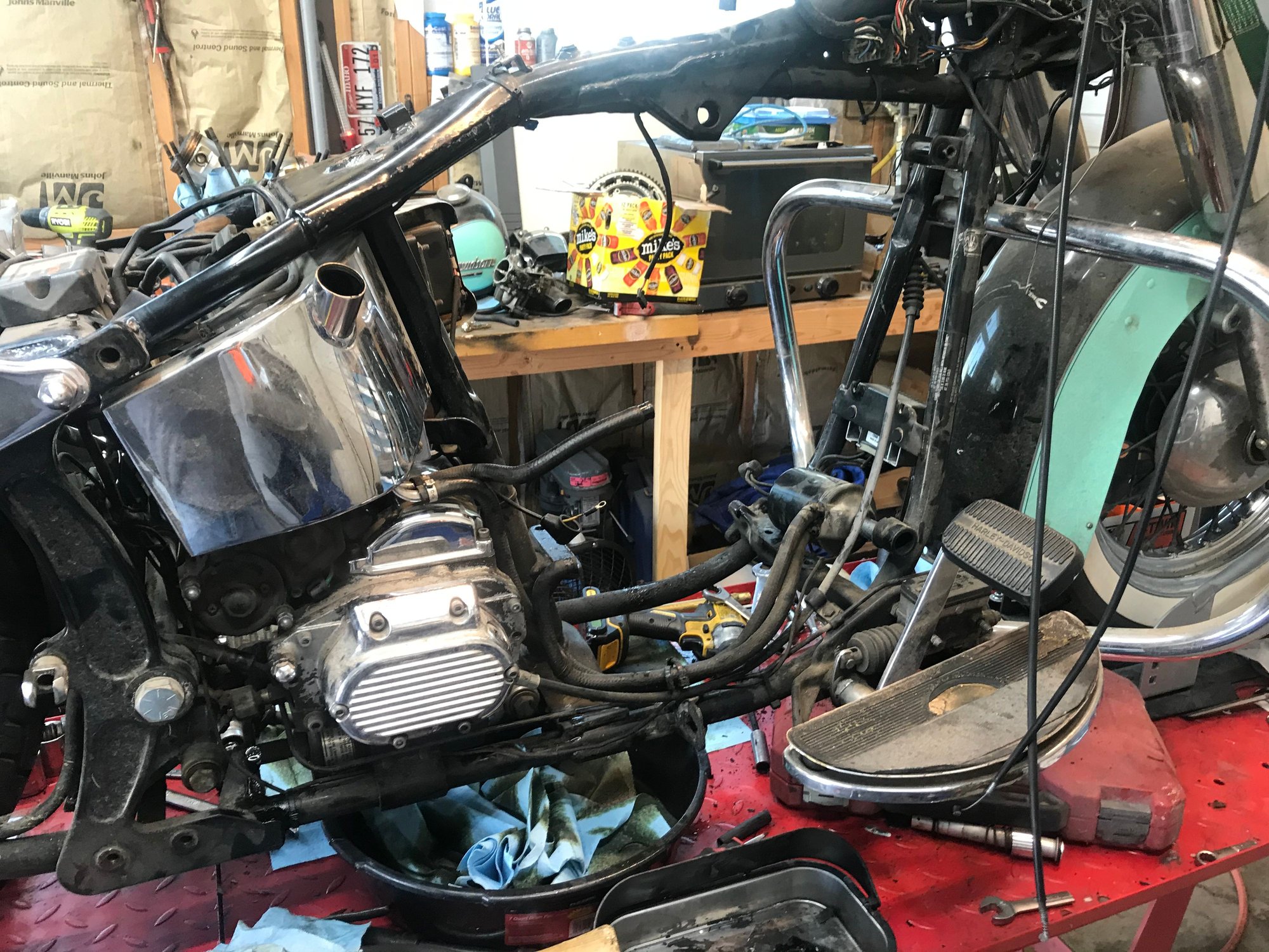

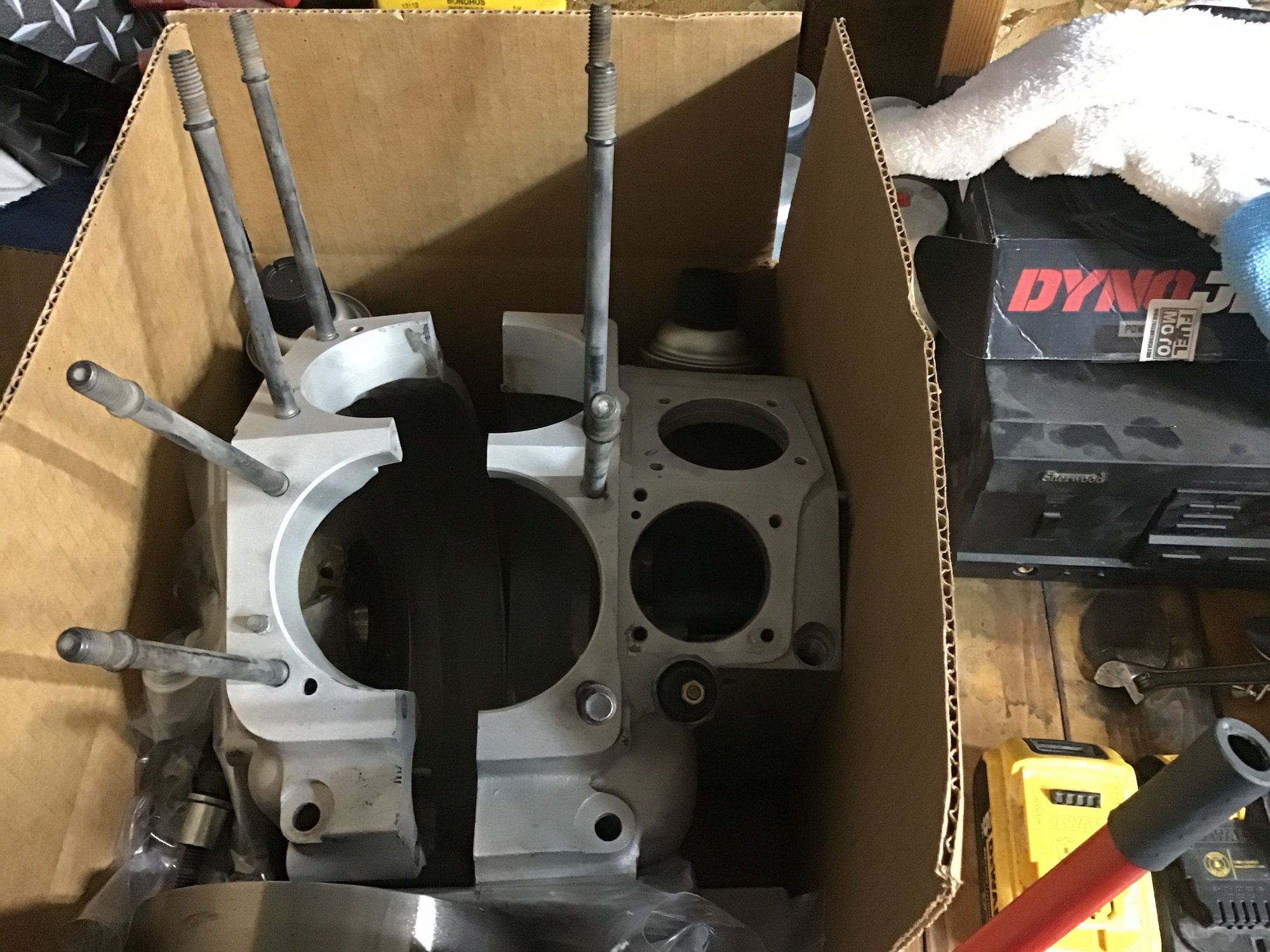

My plans are to fully replace all gaskets and seal while I’m in there I am also replacing all bearings. my machine guy said that the jugs are good but we are taking them out 5 over , powder coating the tranny , inner primary and lower engine cases with the sea foam green. New carb, cam lifters head studs and a lot of Crome polishing.. I am looking at cams now ..

Pictures are not in any type of order ..

Didn't know you were splitting the cases, so disregard my suggestion to not replace the cylinder studs.
If you're ever going to or think you might, now would be the time to do it.....

Default Update

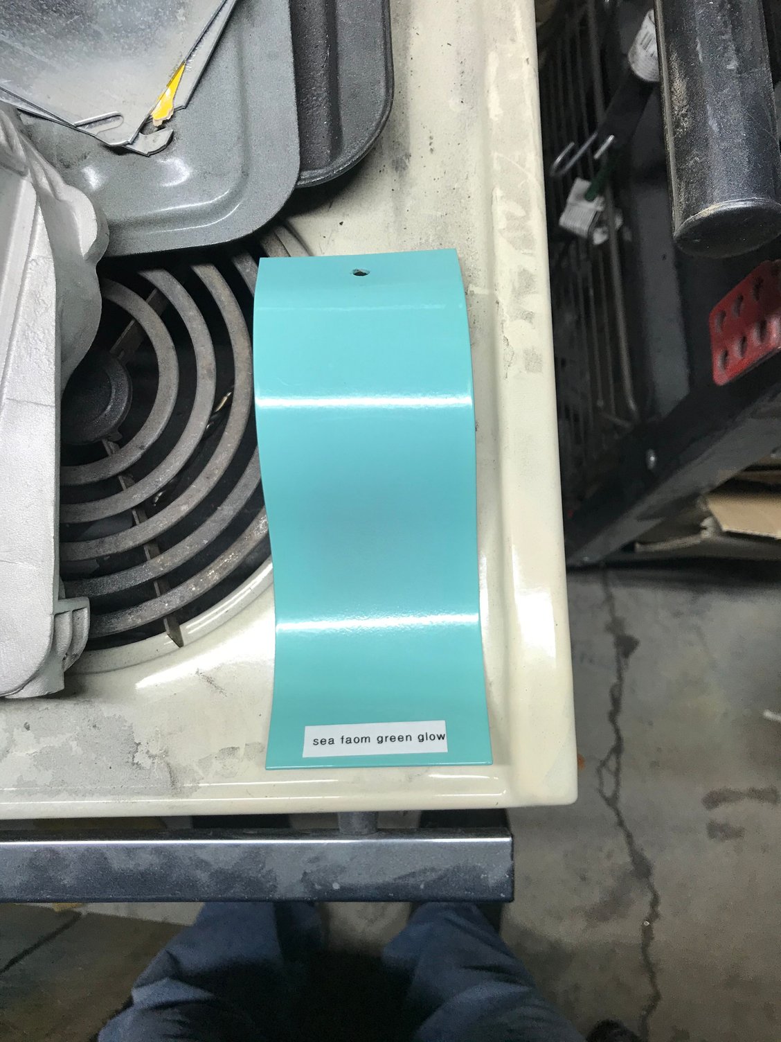

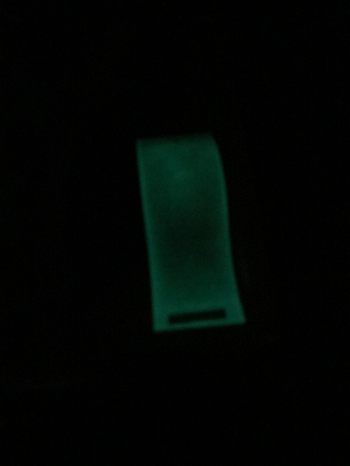

Back from soda blasting
Sea foam green powder coating test panel
Glow in the dark clear

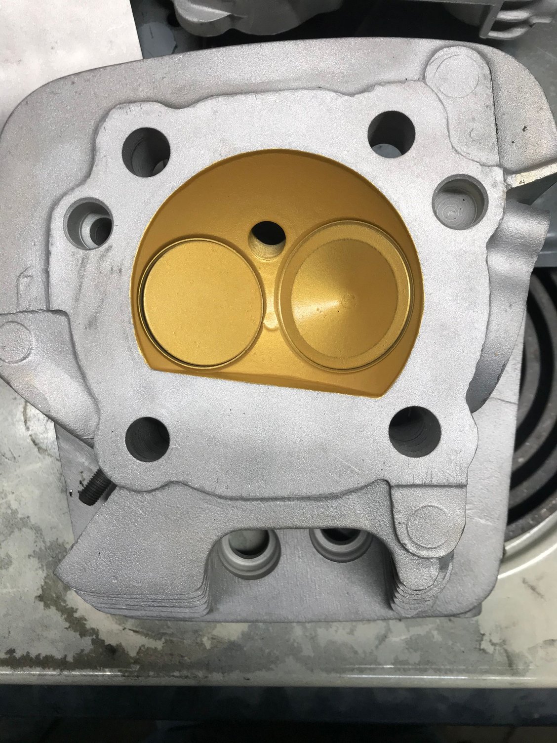

Ceramic coated the combustion cambers today.
