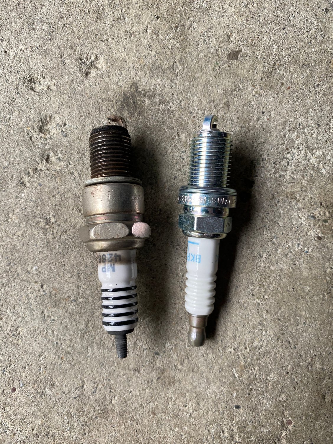

1992 FXRP, stock with a big sucker air cleaner. Replacing spark plugs today and on the left (Autolite AC 4265) came out. Replaced with the right (NGK BPR5ES-11). Both are listed for my model but physically and visually there’s quite a difference. Any problem here or am I ok?. Thanks guys.

You're good.
Looks like you got all the good out of that Autolite... and then some

My thoughts, although the bike is supposed to run a 5 heat range plug, the 5 you have in the bike is burnt to hell, and would try to run a cooler 6 heat range plug or at least tune it with the big sucker in play, so it not running so lean or to much pre ignition to cause the plug problem in the first place.

Depending on how many miles and how you ride....the old plug may not be too bad.
But, those two plugs look totally different size wise. Remember, cross referencing doesn’t always cross reference into your application.
They look the same size at the business end...
There is a conflict of your referenced NGK part numbers, you say BPR, but pic shows BKR...
Good eyes Dan!
And no offense intended but the chart in post 3 should be watermarked "Circa 1969" or something. It's all over the net but the plugs are obviously from a water cooled engine running leaded fuel and has little relevance to todays engines.
